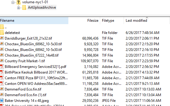

Ugh, sorry! that was a copy/paste error, I am using the syntax <120D.
Any other ideas of why this is not working? Please note my comment that the filter also didn't work with the mast *.psf but did work when I made it the single filename ABBanner.psf...
I've attached a log file from running today minus identifying informaiton. Also a screen shot of the filezilla listing showing files that are <120D.
thanks!
32,326
The /home/forge/ArtUploadArchive is actually a symlink, right?
WinSCP gets confused by that.
Why do you actually use SCP protocol? With SFTP protocol there should be no problem. Or use a final path, instead of the symlink.
