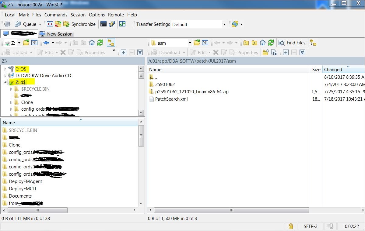

The console window runs with Administrator privileges. Do you also run WinSCP with Administrator privileges? What happens if you run WinSCP from the same console that shows all the drives?

What I was asking you to try: Run WinSCP from a console cmd.exe window, where you can see all the mapped drives. Will you see the drives in WinSCP then? Can you post a (single) screenshot showing both cmd.exe and WinSCP windows and how you run WinSCP?
