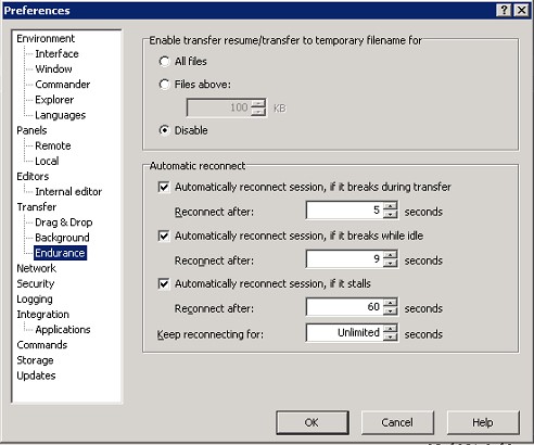

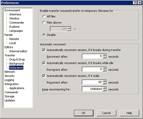

As in the previous thread, I attached the screen shot of the settings we need that work correctly when transferring the file via the WinSCP Client UI. Again just need to know how to accomplish the same functionality when scripting through VB Script.
