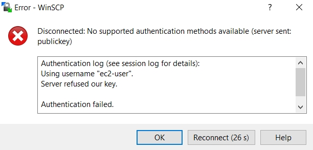

When attempting to login to WinSCP, I'm prompted for the Public DNS, the username (which I'm not sure is ec2-user, root, or ubuntu - so I've tried all three without luck) and the key. I've tried both the .pem and .ppk file, but in all cases, I get an error from AWS EC2.

@martin: You're right, it doesn't really qualify as a WinSCP question. Funny how much you can learn in a few days. In the three days I waited for someone to respond, I figured out how to use WinSCP properly, including the authentication process (and discovering that my instance has a username of "ubuntu", and not "ec2-user"). Anyway, thank you for your response.
