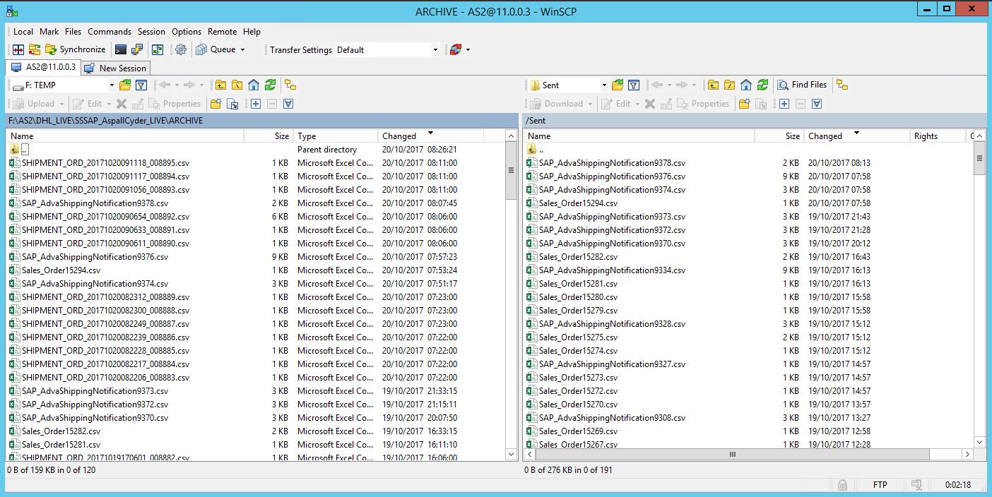

I've attached an image of the gui, in the /sent tab on the right hand side, the changed column only shows the files in hh:MM.
I've attached a log file, the file in question is SHIPMENT_ORD_20171017125346_008758.csv, you can see the copy routine runs at 11:53:55.176 and completes at 11:53:55.304. The file gets added to the folder with the timestamp of 11:53:59, when the copy routine runs 15mins later at 12:08:56.120 it excludes the file. In the log file the timestamp is 11:53AM only.

OK, so the server does not provide the seconds. Then, there's nothing on WinSCP side that can get fixed.
I do not think that you can make Windows IIS FTP server provide the seconds.
As I wrote, you should use a different technique. Your approach is not reliable, even if the server had provided the seconds.
