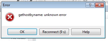

Now the problem is that if you observe the below line in the "Transfer.bat" :
"C:\Program Files (x86)\WinSCP\winscp.exe" /ini=nul /log='C:\WinSCPScript\DateWiseTest\File_Put_!M!D!Y.log' /script=C:\WinSCPScript\DateWiseTest\File_Put.txt /parameter // %%G /!dest_folder!/
in the bold area if I name my log file as "File_Put.log" then it runs fine but when I want to apply DateTime stamps to it as already done like "File_Put_!M!D!Y.log" then it is not running it throws error as attached.
I am very sure that it is taking wrong parameters to File_Put.txt which throws exception.
Please help me to resolve this issue as my target is to generate session log file date wise daily.
Regards,
Ashish Singh Atwal
43,048
Re: Unable to use dateTime stamp in log file name
I assume you have a delayed expansion enabled in your batch file (although your code snippet does not show that).
With delayed expansion, you have to escape the ! with ^.
Also, you have to use double quotes.
/log="C:\WinSCPScript\DateWiseTest\File_Put_^!M^!D^!Y.log"
