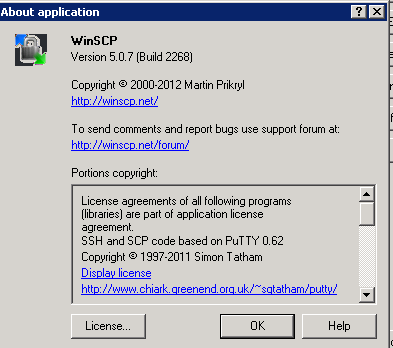

Client runs on the Win 2008 R2 Server German, SP1 64 Bit, Client Version 5.0.7 (Build 2268)

Also, you really need to upgrade WinSCP!
