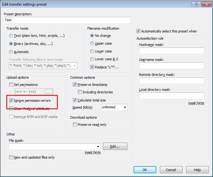

In a VBS Script I need to set Ignore Permission Errors to True, similar to the attached or dialog below:
Can somebody give me the syntax and the enumerated value? I assume in this case it would just be True or False.
IE:
transferOptions.IgnorePermissionsErrors = True?
Thanks!
Description: Ignore Permissions Dialog

Ignore Permissions Error
Martin,
Thank you again for your help. Do you know the syntax in VB Script? I am going convert current scripts to .wsf...
Thanks so much!
I just tried this: It didn't cause an error, but it didn't update the property / setting:
transferOptions.AddRawSettings("IgnorePermErrors") = 1
(edited in 2022 by admin)
In the Session Log I am getting this:
. Script: put  -nopermissions -nopreservetime -transfer="binary"
Thanks!

When I add the following to my VB Script
transferOptions.AddRawSettings("IgnorePermErrors","1")
(edited in 2022)
I get the following error:
Cannot use parenthesis when calling a sub. (800A0414)
The syntax has to be structured differently then in the example you provided as it was an example for PowerShell.
It goes back to my point of a lack of documentation and examples for coding in VB Script.
When you said to set it globally, it appears that it has to be set as part of the session, and the session gets "disposed" Unless there is someway to execute the PowerShell script one time where the configuration setting would stick. In the client it kind of works that way. it is tied to the site profile.
Thanks!

OK, so without parenthesis.
transferOptions.AddRawSettings "Interface\CopyParam\IgnorePermErrors", "1"
Please note that this is not a site to learn a programming in VBScript.
(edited in 2022)
