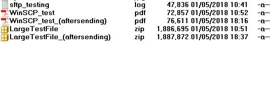

I was able to duplicate the problem today and am attaching the following items:
PP_Image_001.jpg shows the byte sizes from two files, both before being sent via the SFTP process and after. The PDF file was created from your website. The zip file contains some DBF data that does not contain any confidential information, but that said, I would like you to delete this when done with it.
There is a log file of the transmission. The resulting (downloaded) files I renamed only so they would not be confused with the source files.
When you try to open the WinSCP_Test.pdf file it opens fine. Try that though with the (aftersending) version and it fails. Not surprising given the byte size difference.
