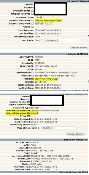

I have been using the dotNet libraries to develop an "EDI over SFTP" connection with a customer.
When I upload files using the WinSCP software, all is OK. When I use the dotNet library, copying the code taken from the Session info in WinSCP, all seems OK on my side - the files upload OK - but the customer claims it does not generate a unique 'External Document Id' (he calls it a SNRF, not sure if that means anything but they are French so could be French abbreviation).
I have attached the information received from the client. When using the WinSCP software, he gets a unique External Document Id (as per the top screen shot, even though he's highlighted Internal Document Id!).
When using the DotNet library, the 'External Document Id' is set to "Upload" (as per lower screen shot), which is the name of the sub-folder that the source file was in on our side prior to upload.

When inspecting my TransferOperationResult.Transfers I can see that the Destination property of each uploaded file contains the subfolder name from my PC.
On my PC, I am uploading 2 files from: E:\WorkingArea\EDI\EDIUpload\Upload_1234
at this line of code:
TransferOperationResult transferResult = WinSCPsession.PutFiles(LocalFolder, RemoteFolder, false, transferOptions);
LocalFolder is: E:\WorkingArea\EDI\EDIUpload\Upload_1234
RemoteFolder is: /**removed**/**removed**/*BIN/
after upload, both TransferOperationResult.Transfers[0] and [1] have a Destination folder of:
/**removed**/**removed**/*BIN/Upload_1234/
So, why has the PutFiles added the Local containing Folder name to the Destination Folder path?
Thanks.
WestcountryBusiness
Torquay
Thanks, Martin,
Can't believe I missed that. I was assuming the FileMask property in TransferOptions was used to identify files & the source path was the folder. My mistake. Thanks for your help
