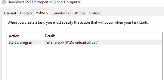

We want to run WinSCP on Windows server 2016 twice a day for downloading reports from FTP site. We created a task scheduler(See the screenshot I uploaded) for the automation and confirmed the task was triggered successfully. However, it didn't call up WinSCP. The weird thing is I was able to run it manually in command prompt, but when I used task scheduler if wouldn't work.. Can someone please help?
