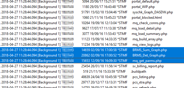

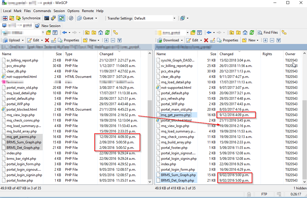

Issue: When the last changed date on an object has a day of the month that is less than 12 then it transposes the date from dd/mm/yyyy to mm/dd/yyyy. (screenshot attached)
From session log (screenshot attached) it shows the date is being retrieved correctly. In New Zealand so use dd/mm/yyyy as default date. Windows set correctly to NZ settings and dates display correctly elsewhere.
I assume this is some US format glitch ... but it would be much beter to display the dates correctly.

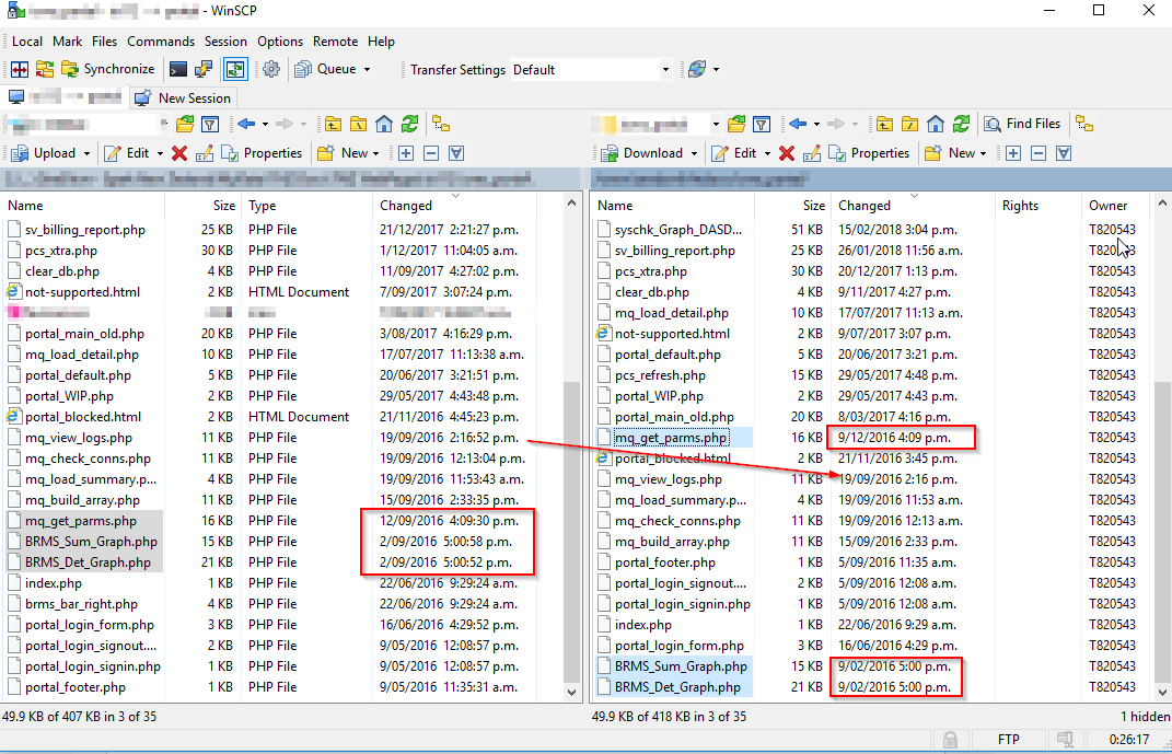

Description: WinScp screenshot

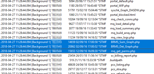

Description: Session log
