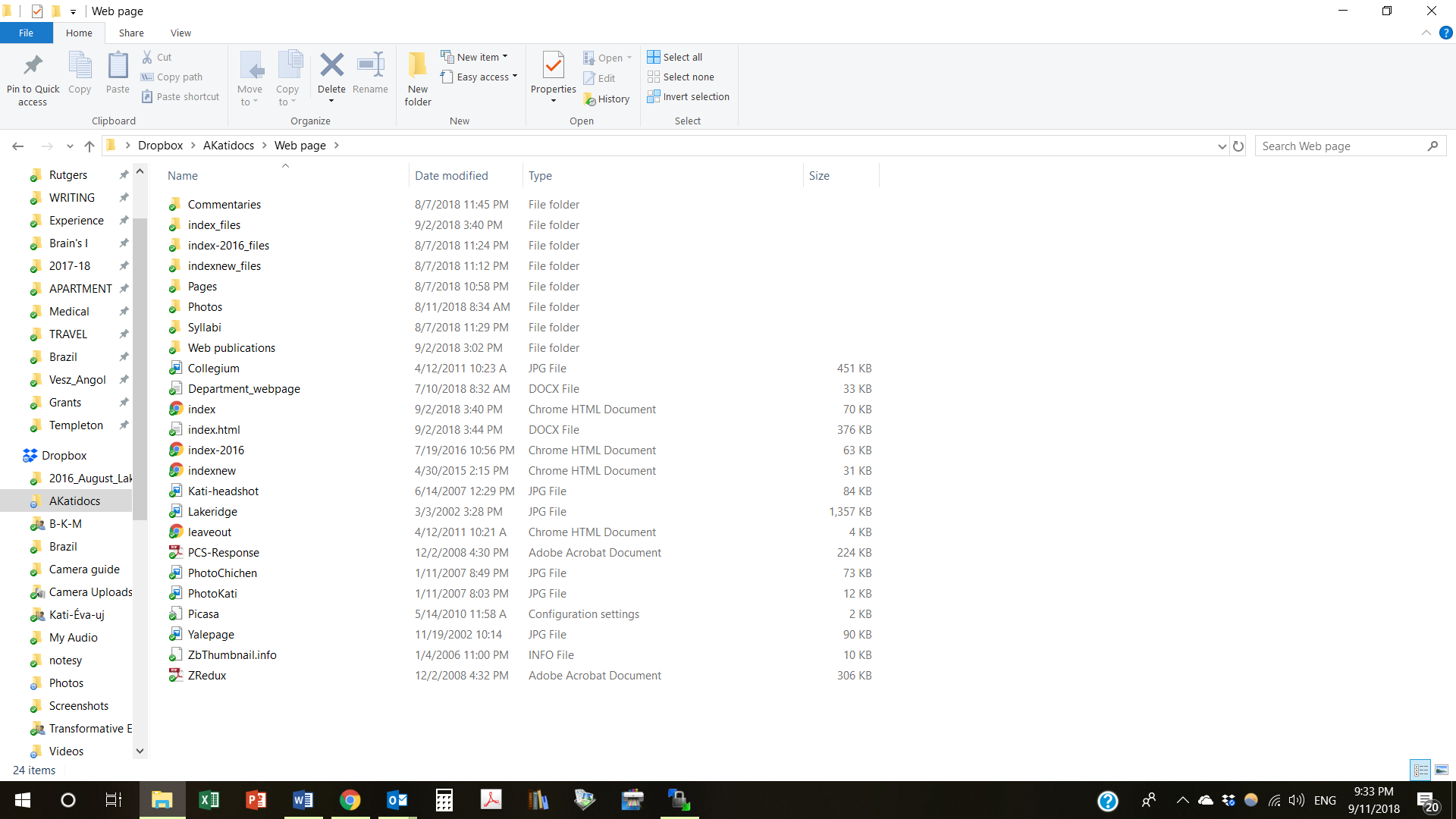

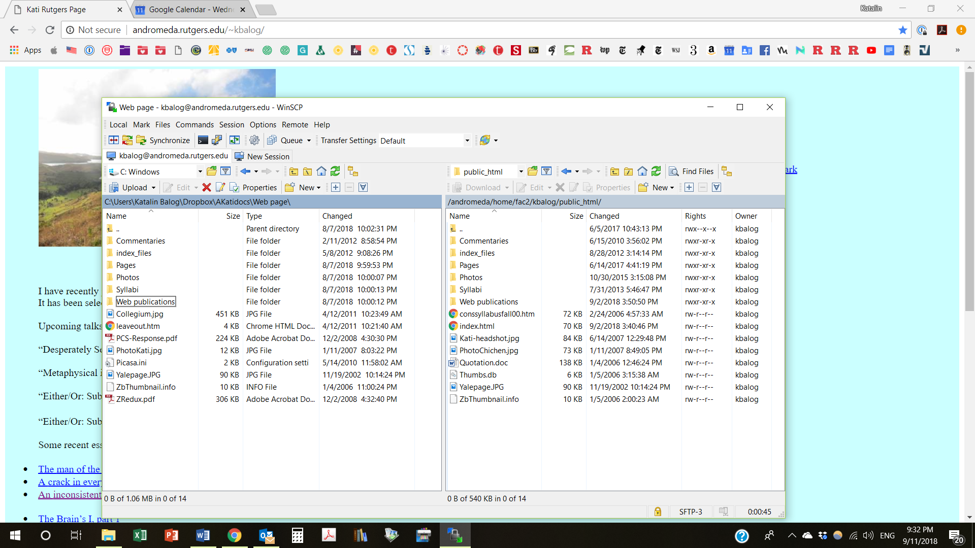

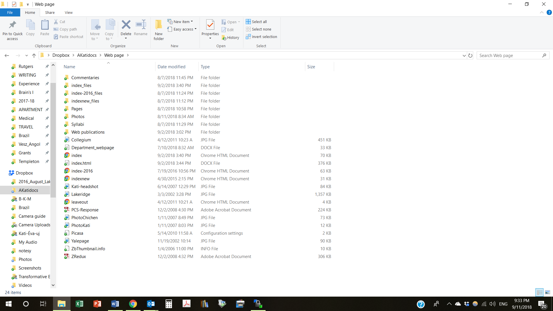

I have just upgraded to the latest version (5.13.4), and, for the first time since I have been using WinSCP, I had issues with local folders and files missing. This seems to be random, not related to file type or anything I can discern. Some folders missing, some folders present but not all files showing....
Is there a setting that has changed? I have re-installed twice but this keeps happening.

Can you post a screenshot of WinSCP panel with files/folders missing and corresponding screenshot from Windows Explorer showing those files/folders?
43,037
Re: local directory missing folders and files
Do you have the problem only with the "dropbox" folder?
Can you see all files, if you go to command prompt (cmd.exe) and type:
dir "C:\Users\Katalin Balog\Dropbox\AKatidocs\Web page"
Post a screenshot again, please.
