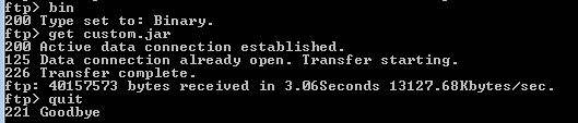

I just did some tests:
Win7 built-in FTP: 105 Mbits/sec
Filezilla:          60 Mbits/sec
WinSCP FTP:         40 Mbits/sec
For the Win7 screenshot below, 40157573 * 8 / 3.06 / 1000000 = 105 Mbits/sec
For the Filezilla screenshot, 7.3 * 8.192 = 60 Mbits/sec
Description: 40157573 * 8 / 3.06 / 1000000 = 105 Mbits/sec
