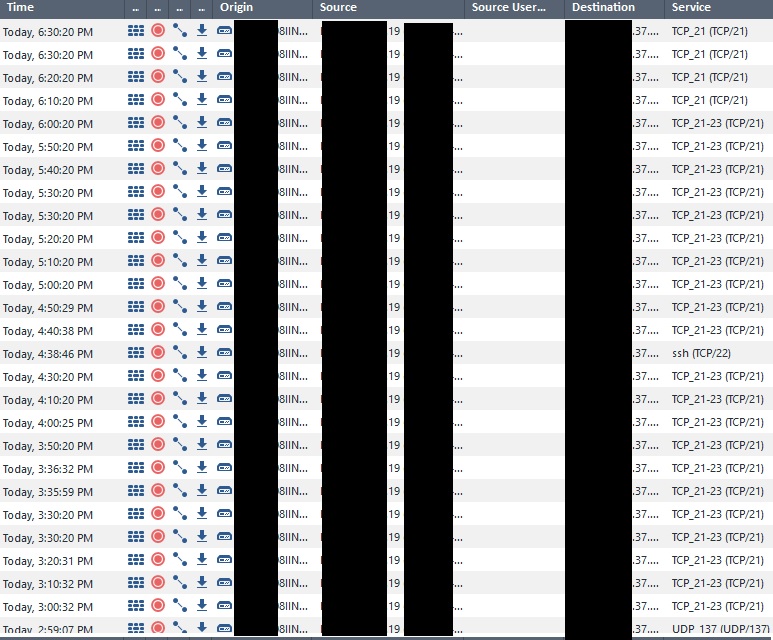

We have a scheduled job that connects to vendor's server every 10 minutes.
This job will upload files to the vendor's SFTP site.
Recently, our firewall log indicates that the port used by SFTP has been changed to port 21 instead of the "hard coded" or default port 22. But in the scheduled job log, it stated the SFTP connecting via port 22.
I would appreciate some insight here.
Below is our batch script to trigger the connection:
option batch on
option confirm off
open sftp://redacted-client-name@XX.XXX.XXX.161:22/ -hostkey="key_redacted with fingerprint ssh-rsa 2048 fingerprint_redacted" -privatekey=local_hostname_redacted-rsa-key -passphrase="passphrase-radacted" -timeout=30
cd /Production
lcd "redacted-file-path"
put -transfer=binary *.pgp *.pgp
exit
Below is the scheduled job log and attached a firewall log

. 2019-07-02 15:20:10.575 Looking up host "remote_hostname_redacted"
. 2019-07-02 15:20:10.575 Connecting to remote_hostname_redacted port 22
. 2019-07-02 15:20:31.589 Failed to connect to remote_hostname_redacted: Network error: Connection timed out
. 2019-07-02 15:20:31.589 Knocking FTP port.
. 2019-07-02 15:20:35.624 FTP port did not open.

. 2019-07-02 15:30:01.285 Connecting to remote_hostname_redacted port 22
. 2019-07-02 15:30:22.304 Failed to connect to remote_hostname_redacted: Network error: Connection timed out
. 2019-07-02 15:30:22.304 Knocking FTP port.
. 2019-07-02 15:30:24.318 FTP port did not open.

. 2019-07-02 16:00:06.050 Bypass authentication: No
. 2019-07-02 16:00:06.050 Try agent: Yes; Agent forwarding: No; TIS/CryptoCard: No; KI: Yes; GSSAPI: No
. 2019-07-02 16:00:06.050 Ciphers: aes,blowfish,3des,WARN,arcfour,des; Ssh2DES: No
. 2019-07-02 16:00:06.050 KEX: dh-gex-sha1,dh-group14-sha1,dh-group1-sha1,rsa,WARN
. 2019-07-02 16:00:06.050 SSH Bugs: A,A,A,A,A,A,A,A,A,A,A,A
. 2019-07-02 16:00:06.050 Simple channel: Yes
. 2019-07-02 16:00:06.050 Return code variable: Autodetect; Lookup user groups: A
. 2019-07-02 16:00:06.050 Shell: default
. 2019-07-02 16:00:06.050 EOL: 0, UTF: 2
. 2019-07-02 16:00:06.050 Clear aliases: Yes, Unset nat.vars: Yes, Resolve symlinks: Yes
. 2019-07-02 16:00:06.050 LS: ls -la, Ign LS warn: Yes, Scp1 Comp: No
. 2019-07-02 16:00:06.050 SFTP Bugs: A,A
. 2019-07-02 16:00:06.050 SFTP Server: default
. 2019-07-02 16:00:06.050 Local directory: default, Remote directory: home, Update: Yes, Cache: Yes
. 2019-07-02 16:00:06.050 Cache directory changes: Yes, Permanent: Yes
. 2019-07-02 16:00:06.050 DST mode: 1
. 2019-07-02 16:00:06.050 --------------------------------------------------------------------------
. 2019-07-02 16:00:06.050 Looking up host "remote_hostname_redacted"
. 2019-07-02 16:00:06.050 Connecting to remote_hostname_redacted port 22
. 2019-07-02 16:00:27.080 Failed to connect to remote_hostname_redacted: Network error: Connection timed out
. 2019-07-02 16:00:27.080 Knocking FTP port.
. 2019-07-02 16:00:29.095 FTP port did not open.

. 2019-07-02 16:40:13.929 Looking up host "remote_hostname_redacted"
. 2019-07-02 16:40:13.929 Connecting to remote_hostname_redacted port 22
. 2019-07-02 16:40:34.969 Failed to connect to remote_hostname_redacted: Network error: Connection timed out
. 2019-07-02 16:40:36.501 Knocking FTP port.
. 2019-07-02 16:40:42.340 FTP port did not open.

. 2019-07-02 16:50:10.060 Connecting to remote_hostname_redacted port 22
. 2019-07-02 16:50:31.082 Failed to connect to remote_hostname_redacted: Network error: Connection timed out
. 2019-07-02 16:50:31.082 Knocking FTP port.
. 2019-07-02 16:50:33.086 FTP port did not open.

Re: SFTP port issue
I'm not sure I understand your question.
Are you saying that your firewall shows that WinSCP uses port 21, even if the script and logs shows that it should use/uses port 22? It's hardly possible.
