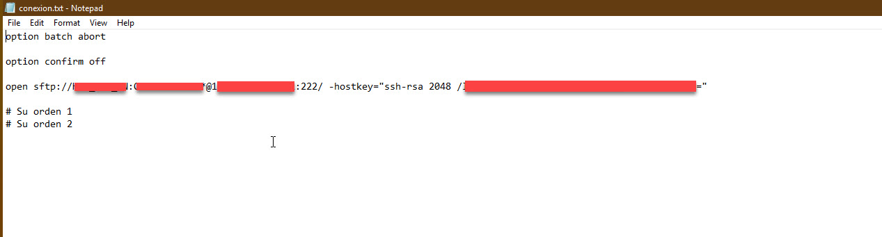

I am integrating SAP with Winscp, through commands.
When I try to open the connection, I get the following error:
batch abort Searching for host... Connecting to host... Authenticating... Continue connecting to an unknown server and add its host key to a cache? The server's host key was not found in the cache. You have no guarantee that the server is the computer you think it is. The server's RSA key details are: Algorithm: ssh-rsa 2048 SHA-256: /l0aIuvWvzSnpwgcCDjyIdxfSOPHs59C8kIsxSkF7KA= MD5: 29:5d:50:6e:8f:0f:a5:6a:c2:c0:f8:0b:26:fe:a8:c3 If you trust this host, press Yes. To connect without adding host key to the cache, press No. To abandon the connection press Ca In scripting, you should use a -hostkey switch to configure the expected host key. (Y)es, (N)o, C(a)ncel (10 s), (C)opy Key, (P)aste key: Cancel Host key wasn't verified! Host key fingerprint is ssh-rsa 2048 /l0aIuvWvzSnpwgcCDjyIdxfSOPHs59C8kIsxSkF7KA=. Authentication failed. External program terminated with exit code 1
This is the command:
/command "option batch abort" "open sftp://user:pass@1url:222/"
Please I need your valuable help.
