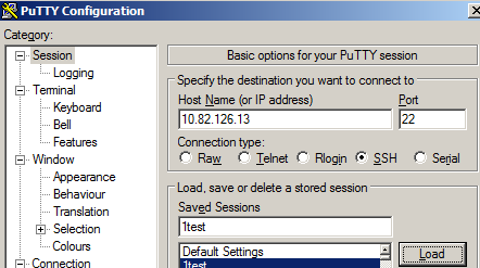

So far I tried:
my session is shown in attachment s1.
A connecton should be opened to the destination machine which is behind a jumphost.

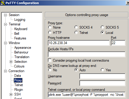

the proxy settings are shown in s2.
For proxyhost name i have entered the ip of the jumphost.
The proxy command is
plink.exe %user@%proxyhost -P %proxyport  -nc %host:%port
When I open the connection, the output in the session window is:
Starting local proxy command: plink.exe user@10.26.238.34 -P 22  -nc 10.82.126.13:22

Using the settings posted as above as screen shots I get
proxy: Access denied"

After I go the hint to check where the password is requested I came across plink option "-pw %pass ".
With this option in the local proxy command and the password in the password field the connection through the proxy works.
