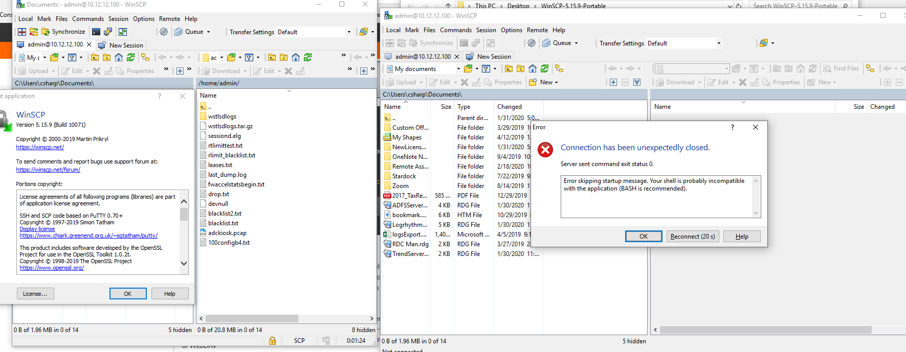

I just updated to 5.17 and when connecting to our gateways, we get the error message "Error skipping startup message. Your shell is probably incompatible with the application (BASH is recommended.)" This is normally where I would have to go in and change the shell to bash, but I have confirmed the shell is set to bash. I grabbed the 10.15 portable and am able to connect to these same servers via bash without issue. Protocol is SFTP, port 22. Screen capture attached. Remote gateways are running on a 2.6 kernel. Not pressed for a fix since I can use an older portable but wanted to let you know.
