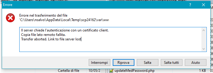

OS: Win 10 Ent.
WinSCP Version: 5.17 (updated today 2020-02-24 from v. 5.15.9).
Tried to save modifications of an edited file (with Npp++). File upload result is the screenshot attached.
A file with the same name has been uploaded but the size was 0 bytes
Never had this problem before with previous versions.

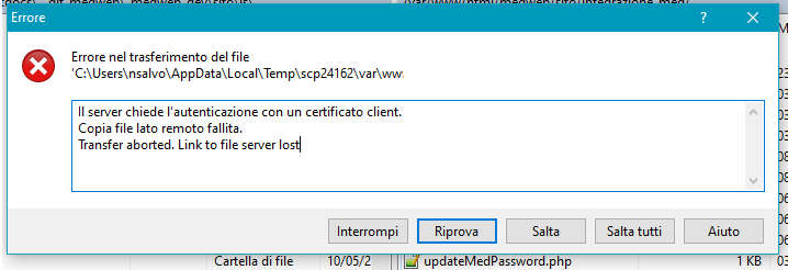

There is a screenshot too, but in english this time...
