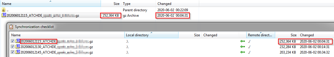

I tried to create a simpler example, not using scripting but via plain WinSCP UI.
In the attached screenshot, you will see that the synchronize function proposes me by default to sync the "202006012115...gz" file from remote to local, whereas it is alread present locally, with the same date and the same size. I woudl expect this file to be unchecked by default, while the other two remote files to be indeed selected by default, as they are not present locally.

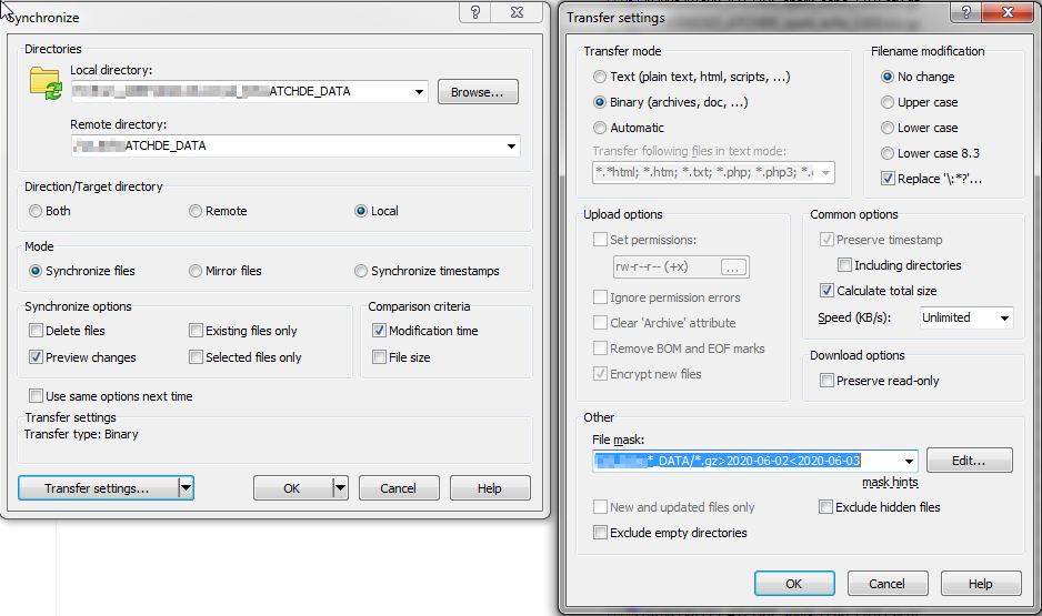

PS: I've also added the options used for synchronize, just in case.

Re: Synchronize redownloads all files at each run, even existing/up to date ones
But I need the session log. Strange is that there's no time and size of the local file in the checklist window.
