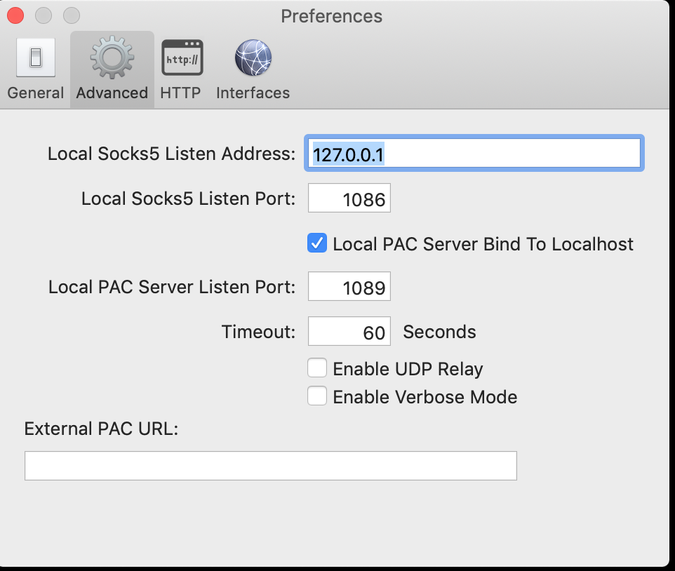

What do you recommend for a socks5 server on linux? I use shadowsocks which uses encryption. It doesn't seem like that will work with winscp then? Maybe I can disable encryption?
Port 1089 is the local port that the shadow socks client uses. I thought winscp could connect through the shadow socks client to the shadowsocks server using the local port? I initially tried winscp without going through the client but that failed so I tried other methods. Here is an example where they use port 1080 as the local port. https://www.linuxbabe.com/linux-server/setup-your-own-shadowsocks-server-on-debian-ubuntu-centos#:~:text=Setting%20Up%20Shadowsocks%20on%20Your%20Server&text=First%2C%20install%20python%20pip%20and,make%20encryption%20a%20little%20faster.&text=Create%20a%20configuration%20file%20with%20a%20command%20line%20text%20editor%20like%20nano%20.&text=Put%20the%20following%20text%20into%20the%20file.
3. Do I need to setup firewall rules to allow the socks server to forward scp traffic directly to the linux host?
Rules where? Your machine needs to have a network connectivity to the SOCKS server. And the SOCKS server needs network connectivity to the Linux host.
Since my attempts have failed I figured I needed a mechanism to get the scp traffic from the Socks5 host to the linux host?
Re: Can't get winscp to copy files through socks5 server to destination host
Then I do not understand what is 8399.
