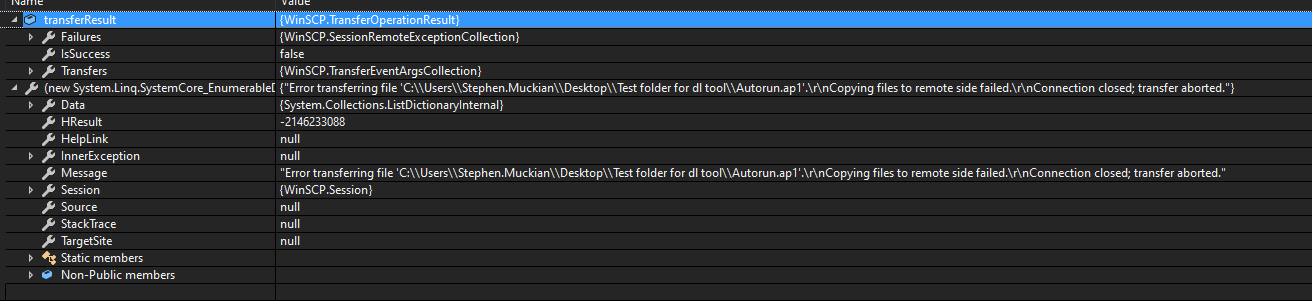

I was having an issue with random disconnections with some code I put together. This code was creating a new FTP session with the "Using" command which meant the session was disposed after every transfer.
I noticed that around 1-2 mins after the original session was disposed, I would get disconnected on the next transfer. I decided this was the wrong way to do things anyway and rewrote it to use a single session for everything.
This has worked fine, but now I wanted to implement something so that if a transfer failed for some reason, we would dispose the whole thing, and create a new session and try again. I'm back to the same issue that the dispose seems to cause the next transfer to be killed about 70 seconds in. I can and have mitigated this, by delaying any subsequent transfers by 2 minutes and this has worked around the issue. This is clearly far from ideal. What is happening with the session.dispose that causes the next transfer to fail about 70 seconds in?

Re: What happens when the object is disposed that would cause a later, new connection to disconnect?
I do not think this has anything to do with your code or WinSCP. Consider checking server-side logs.
If you want us to investigate anyway, please post WinSCP session log files.
BananaCabbage
Hi Martin,
Unfortunately the server side is a closed source PLC with no logs that we can access.
I've been trying to get a clean log of the issue for the last few days, but I keep having various issues with the server side that are making it difficult.
The thing is, if we wait 2 minutes it *always* works. I'm going with this solution for now, as it's only when a download fails, which should be a rare occurrence and I've spent too much time trying to dubug this already.
Thanks for your help anyway.
