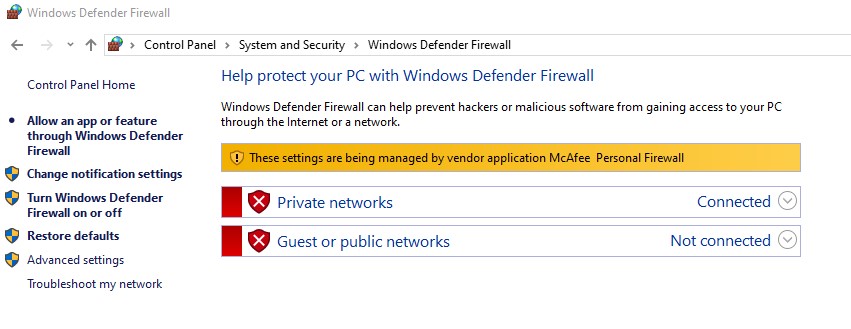

I also looked into changing firewall exceptions.
Control Panel>System and Security>Windows Defender Firewall>Check firewall status (see att.)
But it looks like McAfee handles this.
Don't know if it is significant.
