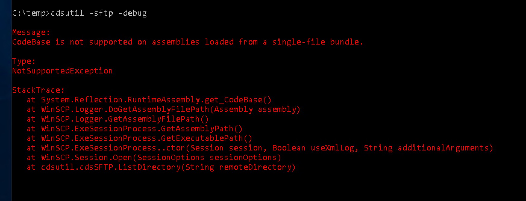

Unfortunately it doesn't work with that yet. I still get the following error message if I set
PublishSingleFile=true
    WinSCP.SessionLocalException: The winscp.exe executable was not found at location of the assembly WinSCPnet (), nor the entry assembly Xxxxx (), nor in an installation path. You may use Session.ExecutablePath property to explicitly set path to winscp. exe.
I haven't had time to test if it works when I set
ExecutablePath. I'll test it with that as soon as possible. It would be great if you could check that again, too.
