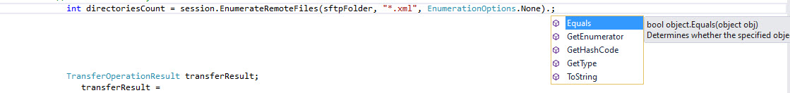

I see examples like this one where you get the count but when I type in .Count it is not accepted as good code. How do you make it so that .Count shows up as an option? (see attached image) This may sound like an elementary question but I am not a professional programmer. Just trying to piece things together. Thanks.
int directoriesCount = session.EnumerateRemoteFiles(
    sftpFolder, "*.xml", EnumerationOptions.None).Count;
35,438
There's no .Count. There's .Count() extension method. For that you need:
using System.Linq;
