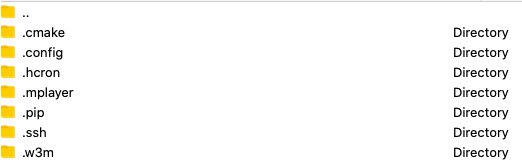

I seem to have an issue with accessing hidden folders using the command line. The folders I am trying to access are in the /root/ folder and are visible via FTP but not via WinSCP. If I load the WinSCP client and go to 'Options -> Preferences -> Panels' and tick 'Show hidden files' I can then see them in the client, but I need to use command line,
If I try and access them in command line it says 'Error listing directory '/root/.hcron'.
Is there a switch or something I can use to view/access these folders?

The folder I need to get to is .hcron which is sat under the root folder. As you can see, it fails in command line but is visible in GUI (after enabling show hidden folders).
Thanks for your support, let me know if you need anything else to diagnose.

Sorry, you are right. So can you access the folder using any SFTP client at all?
Also please post session log file from the script (not only the command-line output). Use /log=c:\some\path\winscp.log /loglevel=2
omega1
6
Hi Martin, thanks for your continued help.
I can access fine with Filezilla in SFTP mode, all folders and files display and can be downloaded.

> 2021-01-05 12:41:53.367 Script: get "/root/.hcron/events/*.*"
> 2021-01-05 12:41:53.367 Script: Parameter: /root/.hcron/events/*.*
. 2021-01-05 12:41:53.367 Listing directory "/root/.hcron/events".
> 2021-01-05 12:41:53.367 Type: SSH_FXP_OPENDIR, Size: 63, Number: 267
> 2021-01-05 12:41:53.367 0B,00,00,01,0B,00,00,00,36,2F,72,6F,6F,74,2F,99,68,63,72,6F,6E,2F,74,77,69,
> 2021-01-05 12:41:53.367 74,74,65,72,31,2E,65,61,73,79,77,65,62,63,6F,6D,6D,75,6E,69,63,61,74,69,6F,
> 2021-01-05 12:41:53.367 6E,73,2E,63,6F,6D,2F,65,76,65,6E,74,73,
. 2021-01-05 12:41:53.367 Sent 67 bytes
. 2021-01-05 12:41:53.367 There are 0 bytes remaining in the send buffer
. 2021-01-05 12:41:53.367 Looking for network events
. 2021-01-05 12:41:53.367 Timeout waiting for network events
. 2021-01-05 12:41:53.367 Waiting for another 4 bytes
. 2021-01-05 12:41:53.367 Looking for incoming data
. 2021-01-05 12:41:53.384 Detected network event
. 2021-01-05 12:41:53.384 Enumerating network events for socket 1260
. 2021-01-05 12:41:53.384 Enumerated 1 network events making 1 cumulative events for socket 1260
. 2021-01-05 12:41:53.384 Handling network read event on socket 1260 with error 0
. 2021-01-05 12:41:53.384 Waiting for another 4 bytes
. 2021-01-05 12:41:53.384 Looking for incoming data
. 2021-01-05 12:41:53.384 Looking for network events
. 2021-01-05 12:41:53.384 Received 33 bytes
. 2021-01-05 12:41:53.384 Timeout waiting for network events
. 2021-01-05 12:41:53.384 Read 4 bytes (29 pending)
. 2021-01-05 12:41:53.384 Read 29 bytes (0 pending)
< 2021-01-05 12:41:53.384 Type: SSH_FXP_STATUS, Size: 29, Number: 267
< 2021-01-05 12:41:53.384 65,00,00,01,0B,00,00,00,02,00,00,00,0C,4E,99,20,73,75,63,68,20,66,69,6C,65,
< 2021-01-05 12:41:53.384 00,00,00,00,
< 2021-01-05 12:41:53.384 Status code: 2, Message: 267, Server: No such file, Language:
. 2021-01-05 12:41:53.384 Asking user:
. 2021-01-05 12:41:53.384 Error listing directory '/root/.hcron/events'. ("No such file or directory.
. 2021-01-05 12:41:53.384 Error code: 2
. 2021-01-05 12:41:53.384 Error message from server: No such file")
< 2021-01-05 12:41:53.384 Script: Error listing directory '/root/.hcron/events'.
< 2021-01-05 12:41:53.384 Script: No such file or directory.
< 2021-01-05 12:41:53.384 Error code: 2
< 2021-01-05 12:41:53.384 Error message from server: No such file
. 2021-01-05 12:41:53.384 Script: Failed

2021-01-05 12:49:19 62845 1 Trace: CControlSocket::SendNextCommand()
2021-01-05 12:49:19 62845 1 Trace: CSftpListOpData::Send() in state 2
2021-01-05 12:49:19 62845 1 Trace: CSftpListOpData::Send() in state 3
2021-01-05 12:49:19 62845 1 Command: ls
2021-01-05 12:49:19 62845 1 Status: Listing directory /root/.hcron/events
2021-01-05 12:49:19 62845 1 Trace: CSftpListOpData::ParseResponse() in state 3
2021-01-05 12:49:19 62845 1 Trace: CControlSocket::ResetOperation(0)
2021-01-05 12:49:19 62845 1 Trace: CSftpListOpData::Reset(0) in state 3
2021-01-05 12:49:19 62845 1 Status: Directory listing of "/root/.hcron/events" successful
Didn't you edit the log file somehow? The SSH_FXP_OPENDIR dump shows that you are listing folder /root/hcron/<hostname>/events and not /root/.hcron/events.
