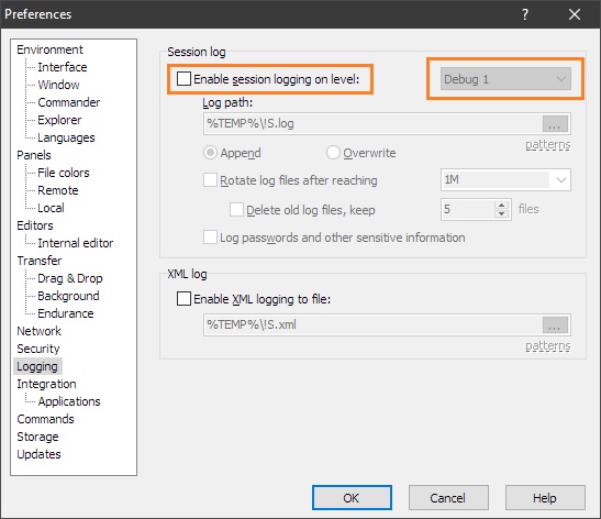

Update:
I've got it.
I've used logging for a while and then disabled it. It seems the console still generate some log regardless of the checkbox condition ("Enable session logging on level:"), when the dropdown box is set to "Debug 1" or "Debug 2" (even if it is greyout).
So, I had to set the option to "Reduced" (or "Normal") and the problem is gone.

Update:
I've got it.
