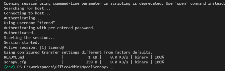

In my case, I'd like to copy files in a list to an SSH server. So I guess you want something like that. This is my batch file and it run well.
set WINSCP=D:\Softwares\winscp.com
set REMOTE_STRING=tiennd:password@techlinkvn.com
set REMOTE_FOLDER=/home/tiennd/MycelScrapy/
set SRC_LIST=README.md scrapy.cfg
@echo off &SETLOCAL
setlocal EnableDelayedExpansion
set winscp_commands=
(for %%f in (%SRC_LIST%) do (
   set winscp_commands=!winscp_commands! "put %%f %REMOTE_FOLDER%"
%WINSCP%  %REMOTE_STRING%  /command   %WINSCP_COMMANDS%  exit
