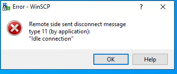

Additionally I get the following message from time to time and is not able to reconnect automatically... Seems /synchronize is not really good for automation...

Indeed, /synchronize is not for automation. For automation, use scripting and its synchronize command:
https://winscp.net/eng/docs/guide_automation
https://winscp.net/eng/docs/scriptcommand_synchronize
If you want to keep running the synchronization forever, just loop the WinSCP script. For example the following trivial Windows batch file will do:
:LOOP
winscp.com /ini=nul /script=sync.txt /log=sync.log
goto LOOP
