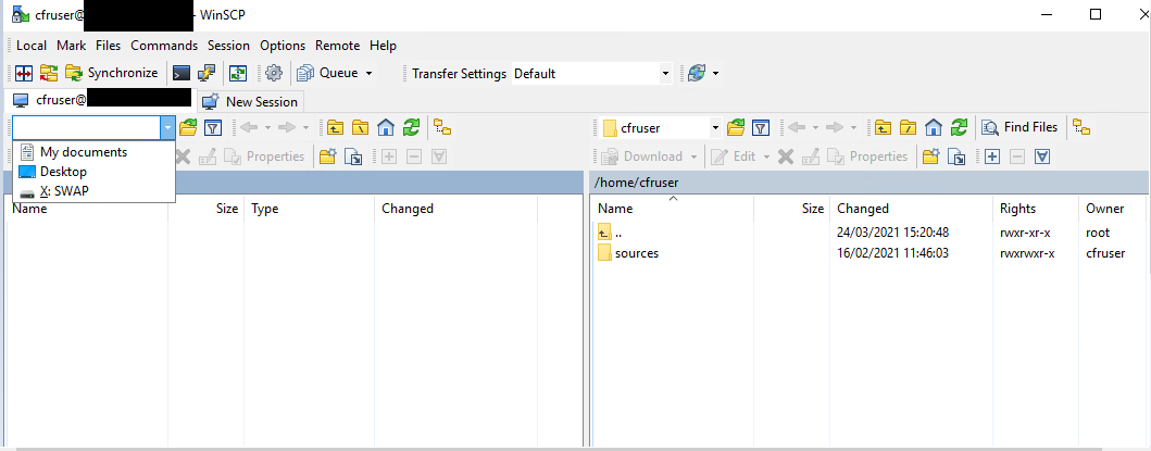

When I connect using the PSM-WinSCP connector on CyberArk, the local disks of the user workstation are not displayed all the time (it works randomly).
When it doesn't work, no disc from the PSM wants to show and I have the following correspondence:

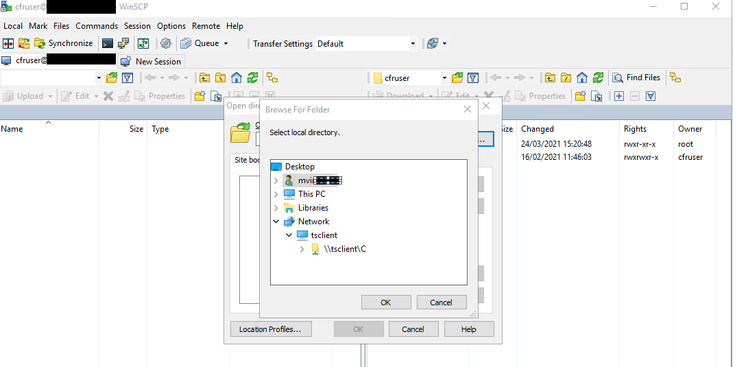

– When I browse my filesystem directly from WinSCP, I can see my disks in the "Network" tab (and not in the directly accessible drop-down list from the home page)

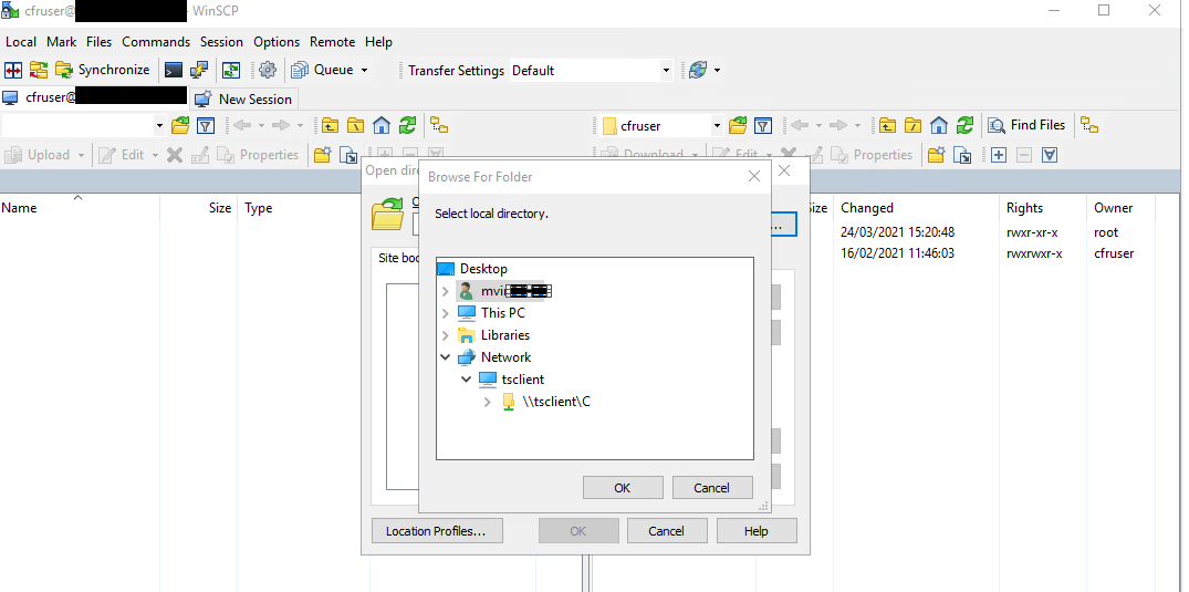

Yes it works for any application. For example, we use the mapping of local drives to connect to web administration platform on Google Chrome and we never have an issue with it.
In the following screens, you can see :

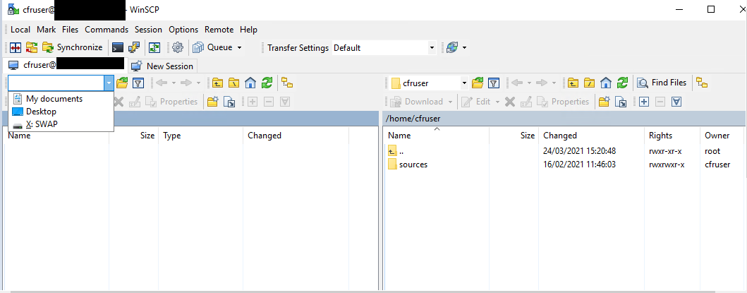

1. That the drives are not displayed in the drop-down list

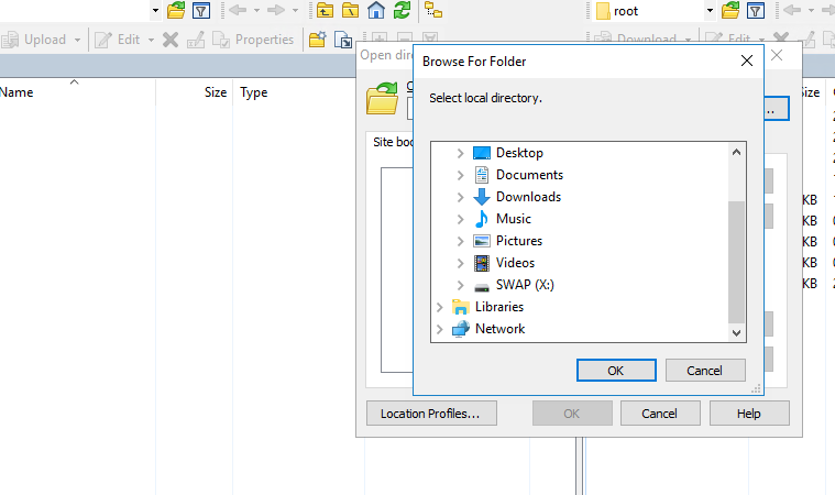

2. That the drives are well mapped through the Windows File Explorer of WinSCP
But as I said previously, the drives are not displayed in the drop down list and we cannot add the drives once the process is launch because UNC Path are not supported.

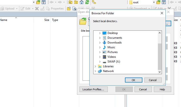

Your screenshot does not show any mapped drive. Mapped drives are under the "This PC", which is collapsed on your screenshot.
mviruser
4
Hi Martin,

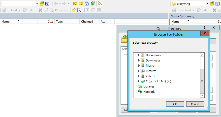

That's a good point. When, it works, I'm able to see the drives mapped (cf functional_test). But, when it doesn't work, I'm stuck with the "X:\SWAP" and this behaviour is identical on my 4 servers. (cf nonfuctional_test)

mviruser wrote:
It seems that the mapping is correct but not displayed in WinSCP then.
What do you mean by mapping is correct? Can you see the mapped drive anywhere else, when you do not see it in WinSCP? In Windows File Explorer? In another other application? So far this does not seem to be WinSCP issue.

Hello Martin,
This may be a language/technical abuse, but since I see the disk in the "Network" tab and can browse and see my personal folders there, it means that the disk mapping is functional and that the intermediate server sees the disk.
Technically, if the mapping with CyberArk hadn't worked, I wouldn't be able to see this "\\tsclient\C" disc in the "Network" tab and would see absolutely nothing. (cf "HOME2.PNG" in the discussion above).
So are you saying that the mapping doesn't work because it is not displayed in "This PC" ?
Thank you for your help and clarification, unfortunately I am not a system expert ...
43,164
The latest version of WinSCP can browse the Windows drives (that have a letter associated, like C: or X:) and UNC paths (like \\TSCLIENT\C).
The old version of WinSCP you have does not support the UNC paths.
But you can map the UNC path to a letter in Windows and then you will be able to use your old version of WinSCP.
