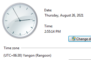

Modified dates of file in FTP are 6 hour ahead of my timezone. I've tried to change the timezone offset in advance setting – it worked, but when I download those files, modified date ares still 6 hours ahead. How can I change it? Does it belong to preserve timestamp feature? My time zone is (UTC+06:30) Yangon (Rangoon). Sorry for my English is not good.

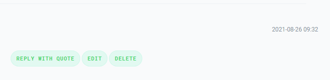

They are the same with this forum posted time, meanwhile our current timezone is nearly 7hours behind. Are you setting WinSCP timezone with your location?
WinSCP application is not anyhow connected to WinSCP site. The timestamps are completely unrelated.
