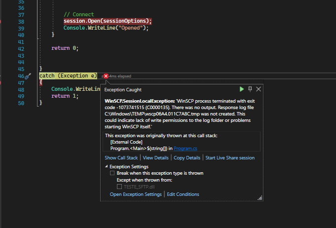

Martin, could you share a example of this project running .NET Core + WinSCP NuGet on Windows container with this simple code?
I'm having the same issue reported by @abraham when I try run a Windows container using Docker Desktop. If you need a example I can post a GitHub repo to reproduce the error. I tried using .NET Core 3.1, 5.0 and 6.0 and in all of those I get the same error.

Martin, I'm using Visual Studio to run and debug the app, the LaunchSettings has a profile to run it using Docker, just select it and run in a container.
As @abraham.dominic mentioned, your Docker Desktop need to be set to run Windows containers.
ps: If your Docker Desktop is configured to run Linux containers it will ask to you if you want to change to Windows container when your start the app.

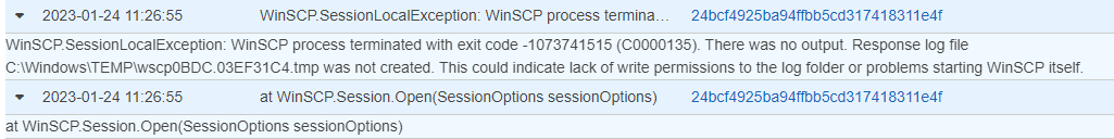

WinSCP process terminated with exit code -1073741515 (C0000135) ECS Farget Windows Container
I have the same problem in windows container ECS Fargate. I using .NET Core 3.1.
