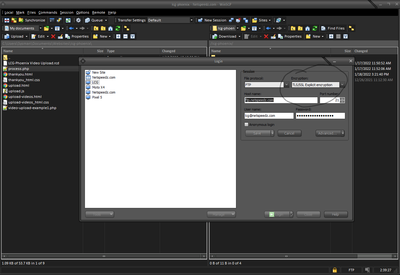

I changed from No encryption to 'TLS/SSL Explicit encryption' and all works regardless of VPN enabled or disabled.
Sure do appreciate the assistance on this.
