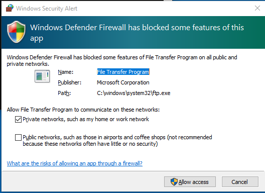

In the above reply I forgot to mention an error popup which occurred when running Windows FTP from the command prompt (screen grab attached). Having ticked the box to allow public networks I successfully completed the interactive and scheduler tests described above.
I emphasise that WinSCP had never displayed any such error message and worked successfully interactively (GUI or command script).

Description: Windows FTP error popup
43,037
Re: Windows 10 FTP transfer connection failed
Windows ftp supports an active FTP mode only. In the mode the client have to listen for incoming connections, when transferring files and listing directories. That's what I believe did trigger the firewall popup, because it needs the incoming port to be opened in the firewall. On the contrary WinSCP (and basically all other FTP clients) uses passive mode by default. And you did not even connect with WinSCP. WinSCP never got to the point of transferring files or listing directories.
See also https://winscp.net/eng/docs/ftp_modes
Also confirming that popup creates firewall rule for ftp.exe only anyway. It should not have any impact on other applications.
So this should not be related at all. But hard to tell...
