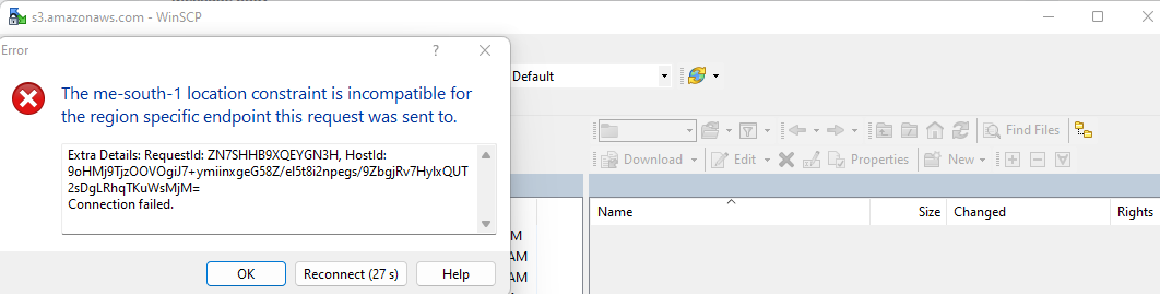

Error while accessing aws s3 bucket in me-south-1 region.
Please find attached error screenshot while configuring to access AWS S3 bucket in me-south-1 region.
Note: IAM credential (Access/Secret key) has permission & able to access buckets in other regions.
Description: Please find attached error screenshot while configuring to access aws s3 bucket in me-south-1 region.

Re: The af-south-1 location constraint is incompatible for the region specific endpoint this request was
@RaviPrasad: I'm not sure I understand your posts. Do you have a problem? Or are your posting your solution? Did you intend to post two same screenshots?
