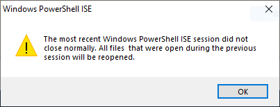

The "crash" is my PowerShell window simply closes and when I reopen it I am told that my last PowerShell session did not close normally, see attachment. Also attached is my session log.
