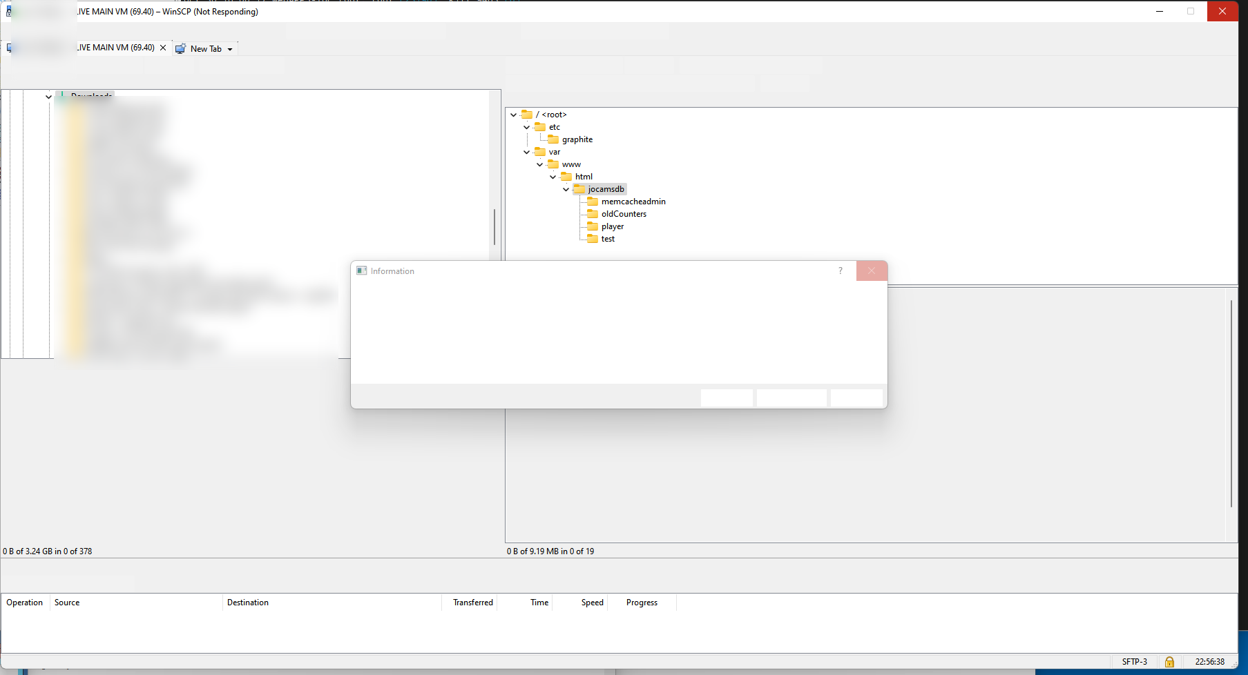

ISSUE: I usually always have WinSCP open in the background, with anywhere from 1 to 10x WinSCP tabs connected. Usually after 12h to 36h WinSCP will lock up (as seen in image below). When it does this, the only way to exit is to Task Manager->Kill winscp.exe. This started about 8 months ago when I did a WinSCP update, after not doing one since ~mid 2021. Prior to the 8month ago WinSCP update, I had never seen this occur with WinSCP at all. (prior WinSCP was very stable, although at times sluggish in the GUI, but overall worked great!). So as of a week ago, I decided to update to latest: my Windows 11, WinSCP, and Nvidia drivers (still at the Nvidia "studio" driver level/type). The issue still occurs.
I'm sorry I cant say the exact WinSCP version # that this started occurring at, however I can say that this does NOT seem to be related to Win11, as when I first built this PC about 1.5yrs ago, I started with a clean/fresh Windows 11 install, and the latest WinSCP, and did NOT see this crash/lockup issue for several months (it seems to have started when I updated WinSCP ~8-12months ago from now)
When this does occur to WinSCP, no other apps seem to be effected. Any suggestions or additional info I can provide?

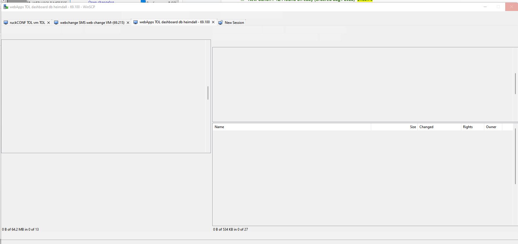

Thanks Martin, I was actually able to capture v6.0 debug version when the issue occurred!
So I will be emailing you the trace log, and here is a screen cap of when it happened:
Description: v6.0 debug locked up
