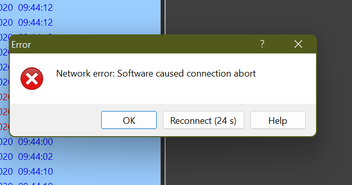

This is weird! Been using WinSCP for years across a number of Win10/11 PCs without any issues at all. I just bought a brand new ASUS Win11 laptop. I exported the settings/config file and then installed WinSCP on my new machine. I imported all the sites and all seemed well.
However, when I launch the App and attempt to connect to a site, I'm getting a random error message. Sometimes it connects to sites, and sometimes it doesn't – the message says 'Network Error. Software caused connection abort'. Any thoughts anyone? Big thanks, Steve

Yes, the laptop connects to the interweb with other apps ie Edge, Firefox and I can send and receive emails. It seems very intermittent. Sometimes it connects with WinSCP, sometimes it doesn't. A second PC using the same setup has no issues.

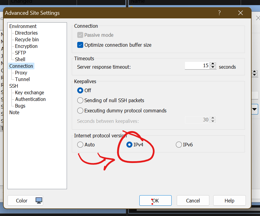

OK, after quite a bit of experimentation, changing various settings, I seem to have solved it!
I'm not techy enough to know WHY it's now fixed, perhaps someone can enlighten me?
Especially given that both my Desktop and this new laptop use the same site connection settings (the same exported config file - the Desktop always connects, but my brand new laptop fails to connect to a number of pre-configged sites on a random basis. The solution was to switch from 'Auto' to 'IPv4' in the 'advanced menu' for the particular sites that were failing. So, anyone know WHY that would sort things out? Both machines are Windows 11 - the desktop is around 5 years old and the troublesome laptop is about 5 minutes old!

Good news. The old machine might have IPv6 disabled.
If you want to dig further into this, please post logs of both successful and failing connection (both from the new laptop).

Indeed, your host has both IPv6 and IP4 address. With "Auto", WinSCP uses the IPv6 address and that does not work well. Do other SFTP client work correctly when using IPv6 address? Though I've actually asked you for "Auto" logs for both successful and failing connection.

Kind of answering my owner question here (I think!). It's certainly an IPv6 issue because if I add a tweak to the registry to prioritise IPv4 over IPv6 (https://learn.microsoft.com/en-us/troubleshoot/windows-server/networking/configure-ipv6-in-windows) then everything works as it should ie Connection set to 'Auto' within WinSCP allows me to connect, whereas before, I had to switch it to IPv4. I know it all amounts to the same thing, but I'm still intrigued as why a brand new laptop should exhibit these issues whereas none of my other PCs running WinSCP have a problem. Love technology! :) Steve
