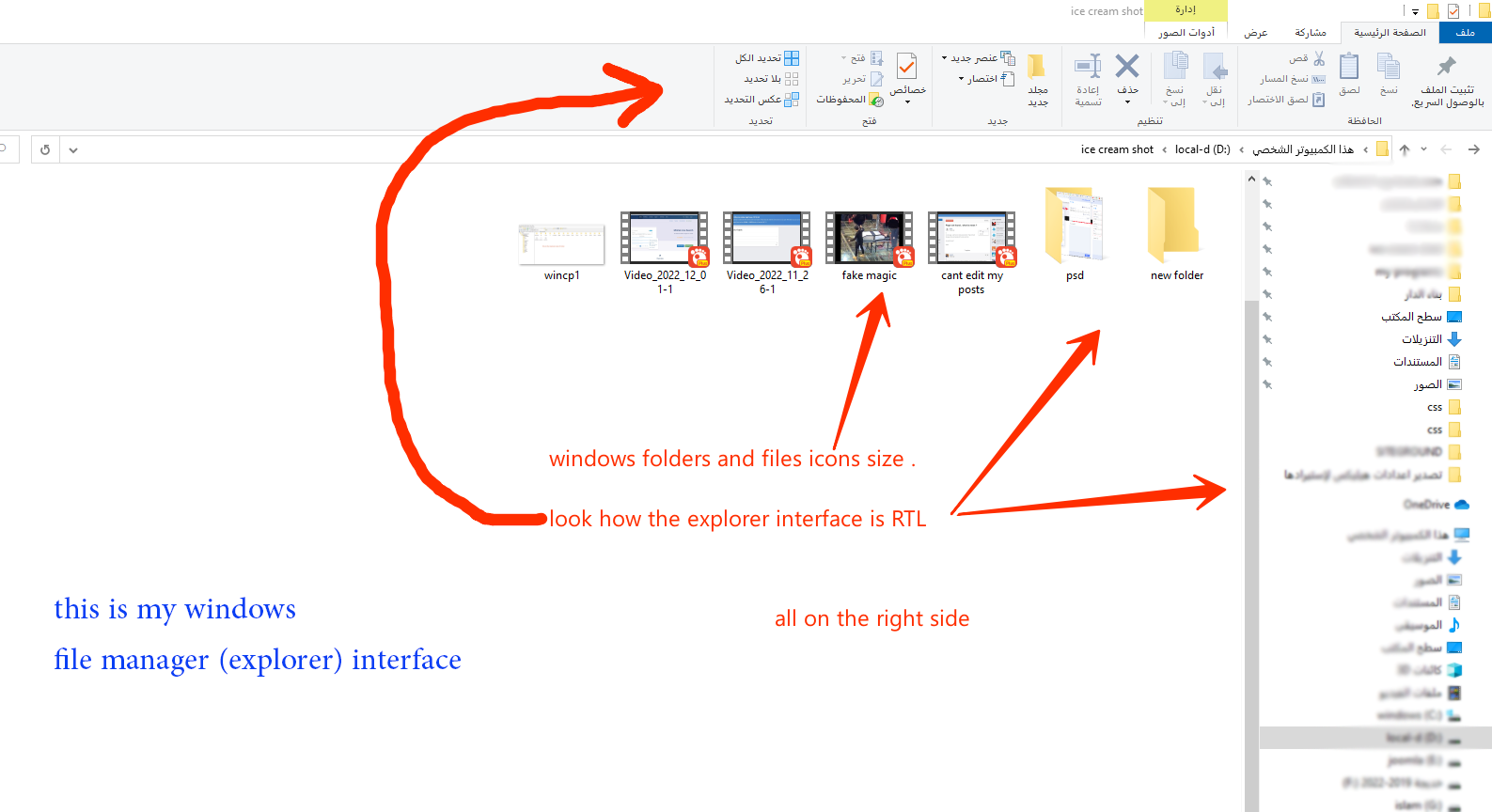

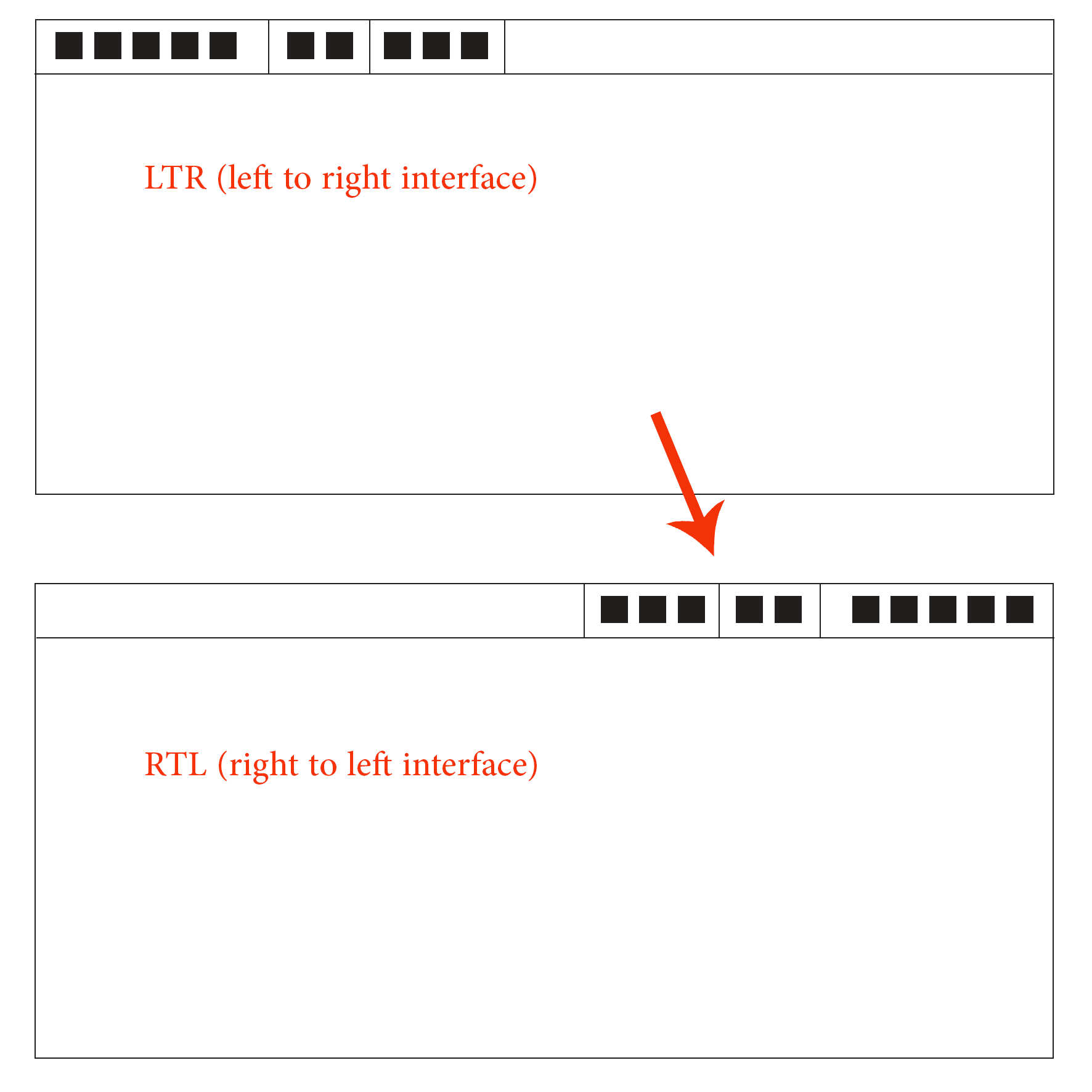

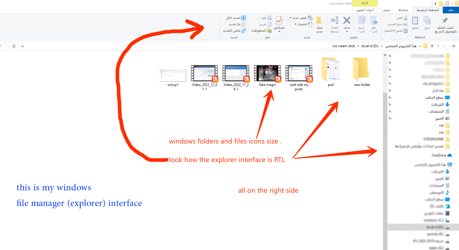

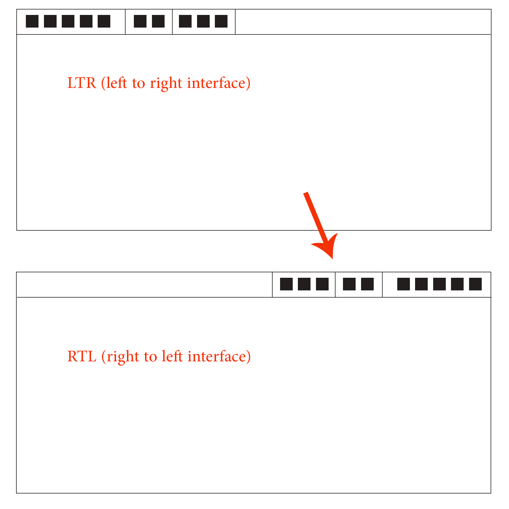

can you add option to turn the interface to RTL direction (right to left)!
My language and my PC is RTL, I need RTL interface. (see attachment)

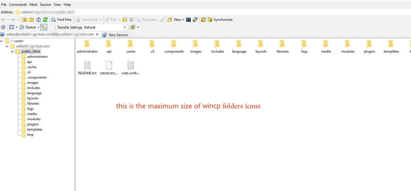

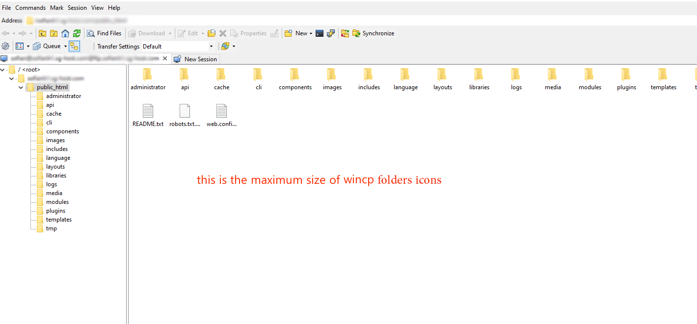

The large icons is smaller than Windows large icons.
Can you make it like Windows large icons size?
I promise I will donate after I get these options (I need them).
If not, I can't use the software.
Thanks

WinSCP follows system scaling. If you set scaling to 200%, WinSCP will display 200% icons. What exactly do you mean by "Windows large icons size"? Can you post a screenshots of what you mean?

I hope you will increase the icons size for folders and files.
And hope you will add RTL to the interface like in my screenshot for my Windows Explorer.
