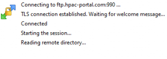

When I set up the site one machine, it connects with no problem.

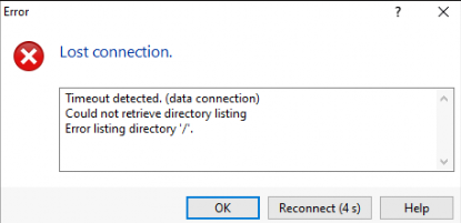

I set up an identical site on a different machine, it gets to the "Reading remote directory..." and hangs up. It then pops up an error saying "Could not retrieve directory listing. Error listing directory '/'."

Description: The error that pops up after trying to read the remote directory for several seconds.
Description: The progress point where the connection hangs up.

Most likely a firewall does not let the FTP data connection through.
If you post session log files from both machines, we might investigate further.
