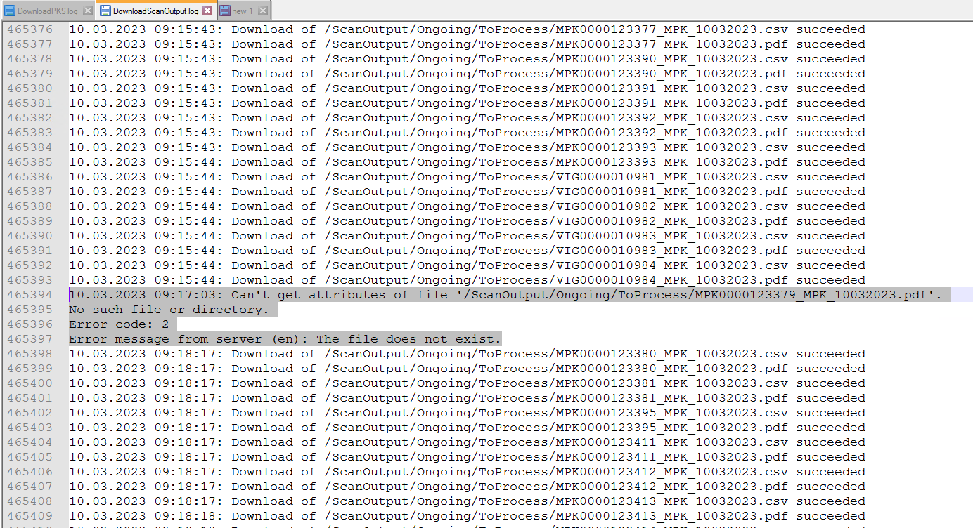

We are using a PowerShell script that is downloading documents from an SFTP server. This was running for quite a long time without any issue, but recently we are running into sporadic error code 2 stating, the file does not exist...? Any idea what could be the issue here?

Logs:
attached
43,115

I can only guess that the file is removed between your script retrieves the list of files to transfer and the time it gets to actual transfer the file. Verify that. Or post a session log file. If it turns out to be the case, you will have to handle that more gracefully – by not aborting the script – what you are currently doing by calling $transferResult.Check(). Instead, test the $transferResult.IsSuccess. See for example Recursively download directory tree with custom error handling

Hey Martin
Many thanks for your feedback. Indeed the files are beeing moved in the same time this script is trying to dowload. Unfortunately the script has been initiated as well on the test environment with the wrong parameters. However, I will update the script and optimize it according to your recommendation.
Best Regards!
