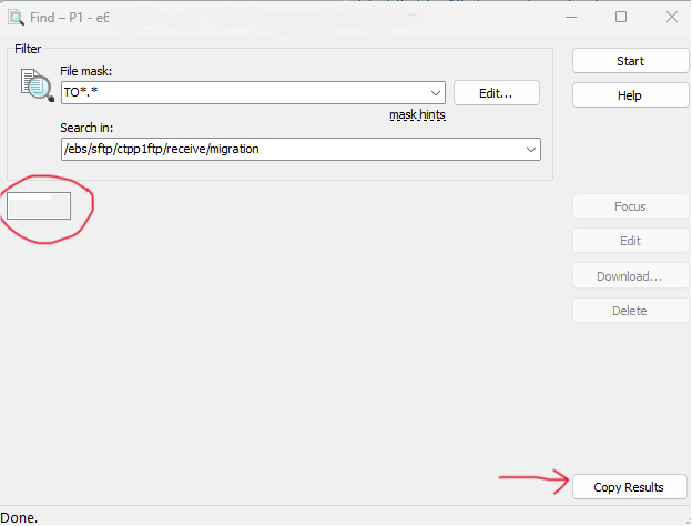

When entering a criteria in the "File mask" field and pressing "Start", I get the result in a very small resultbox. I can not expand it in any way. But if I press "Copy results" and paste it into an editor, I can see the searched files. What can be wrong?
I'm on a Windows 11 Enterprise, using WinSCP version 6.1.2 (Build 13797 2023-09-19)

So is the list view there with the right size, when you open the Find window? And only once you click Start, it shrinks?
SandraAtTietoevry
Re: Find files result window too small (unreadable)
Hi! No, when I click on find, the list view is small. I don't remember when I last saw it with the right size. It has been like this a while for me. :)

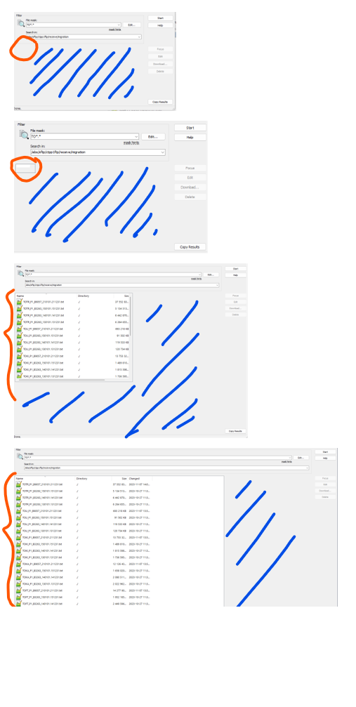

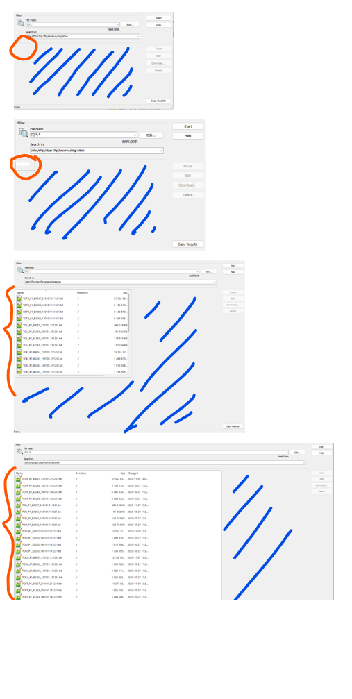

Hi Martin,
I'm attaching a picture of what I mean. When I have the popup window small, I didn't see the resulting list view (red). It would have been nice if it automatically expanded to all the space in the popup window (blue), then I would see it right away. It was hidden for me, and I thought something was wrong with how I wrote my mask.
Thanks,
Sandra
43,080
Well, it should not behave like this. The results list view should always occupy whole Find window. I've never had report of this strange behavior before.
I see on your screenshots that even after you resize the window, it does not fix it. The view still occupies only part of the window.

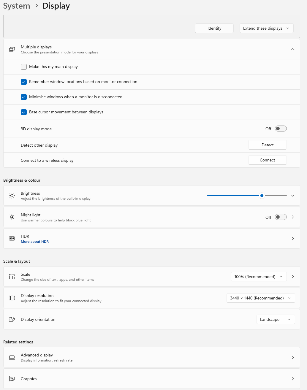

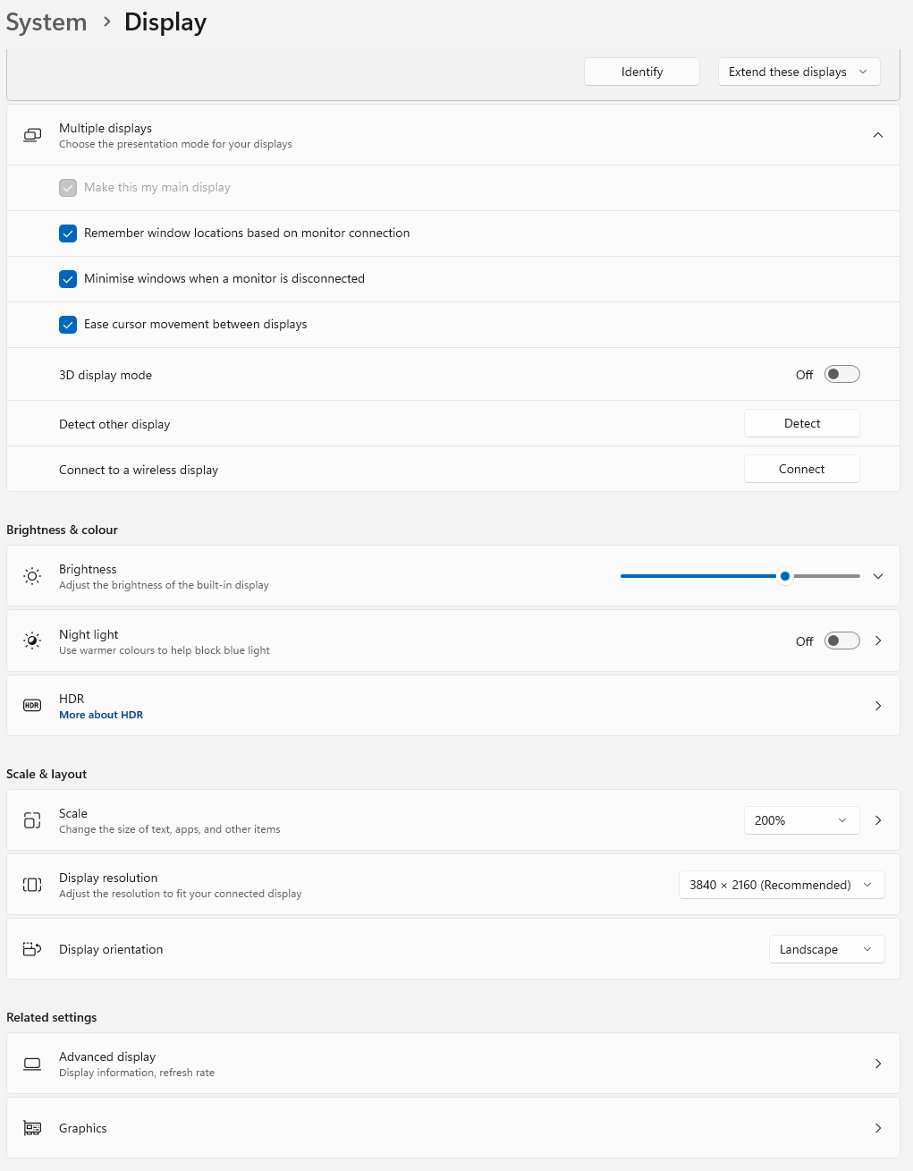

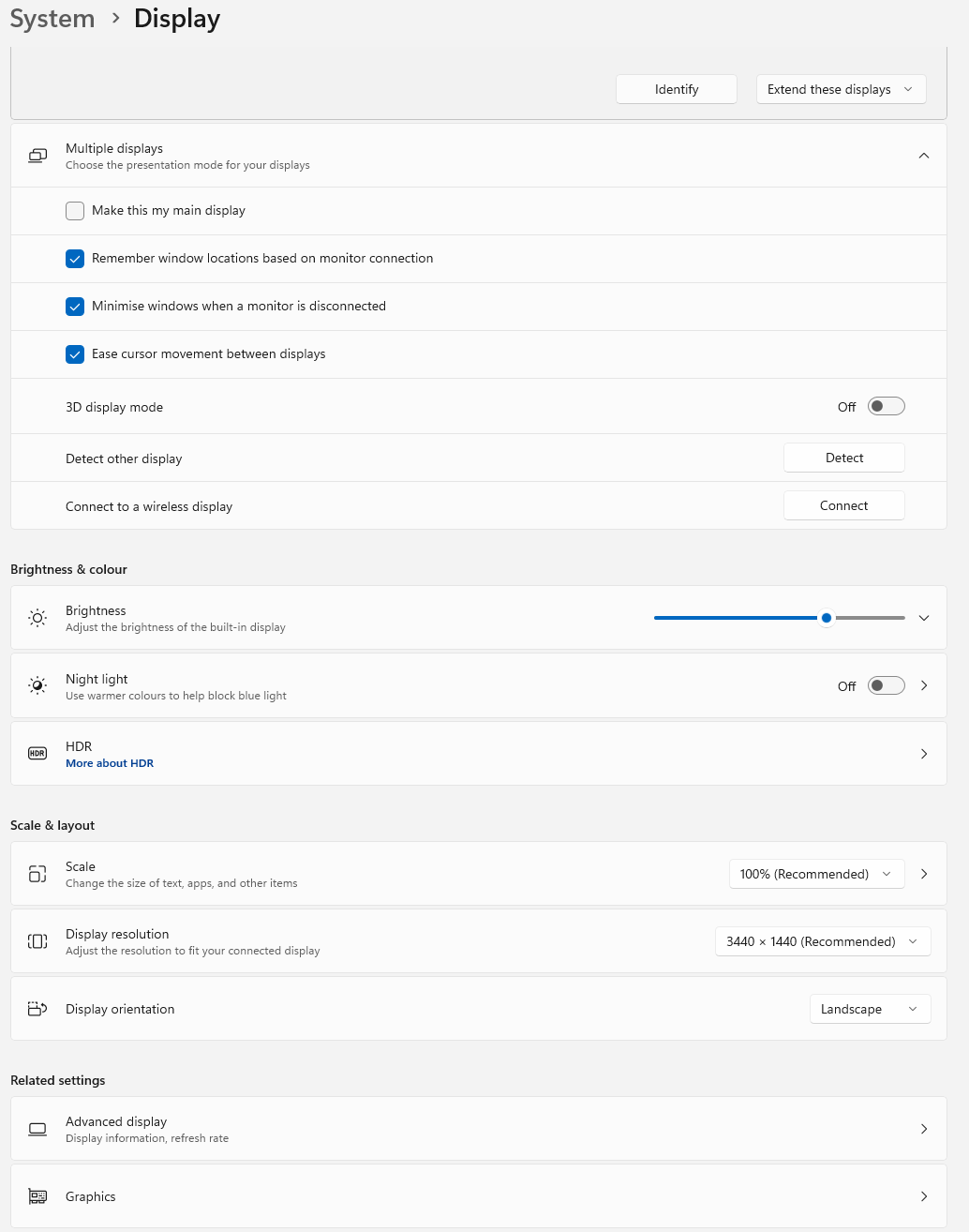

What is your monitor setup? Do you have multiple monitors? Can you post screenshots of the monitors setup in Display pane of Windows Settings? If you have multiple monitors, on what monitor do you start WinSCP and the Find window?
SandraAtTietoevry
Hi again, you are right, it has to do with the monitor I'm using. It works fine as you describe it on my laptop screen (HP Zbook). But on my extended screen (ACER X34 P) it has the problems I described.
Thanks!
43,080
So can you please answer my questions above to allow me to reproduce the problem?
