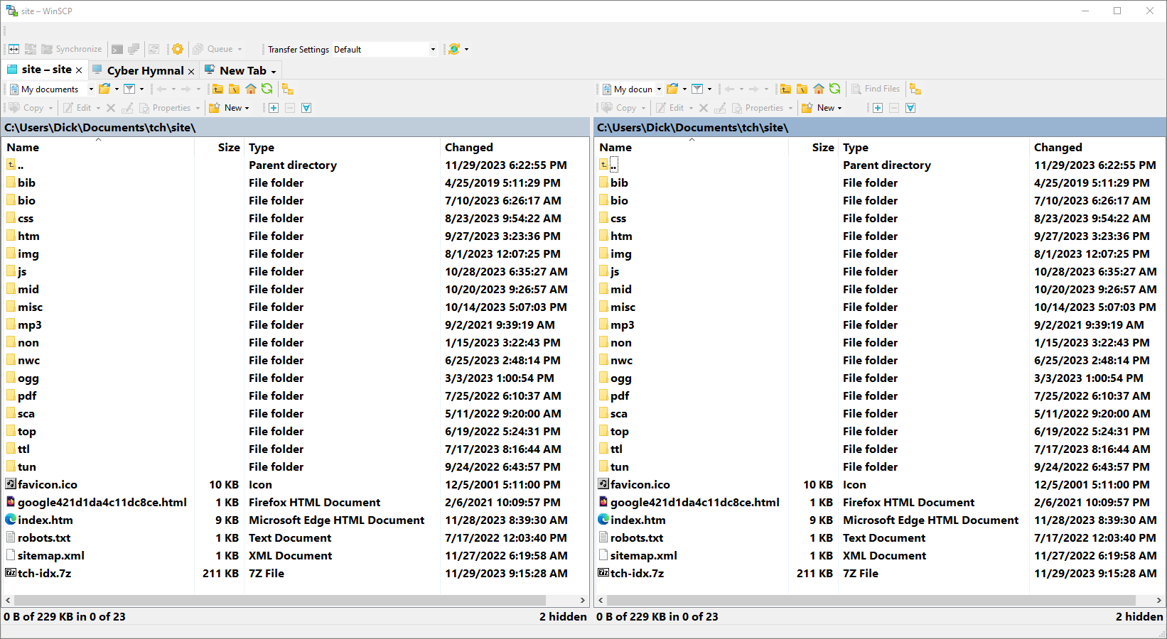

WinSCP used to show the local computer on the left and the remote computer on the right side when I launched WinSCP. I don't know what changed, but now both left and right panels show the local computer when I launch WinSCP. There’s a tool bar button (next to the “New Tab” button) with the remote site name, and the remote site appears when I click the button. But sometimes I forget to click the button and think the right panel already shows the remote site, which gets extremely confusing.

No, the login dialog does not appear. WinSCP just seems to launch normally, and I can’t tell anything’s wrong until I see that both left and right panels show the same folder on the local computer.
The only dialog that opens is the one asking for the master password (same dialog I get even when app is working correctly). No error message ever appears.

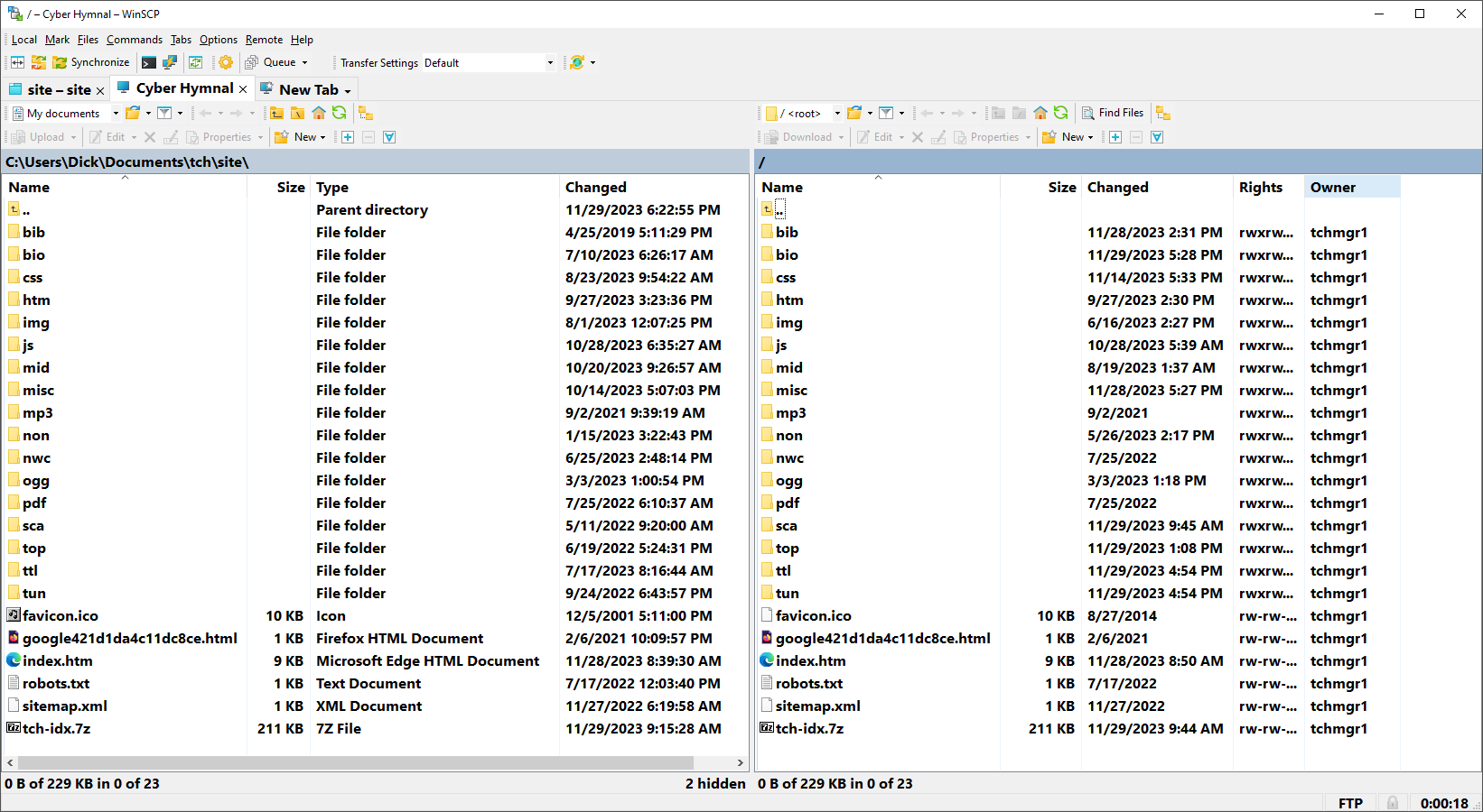

Don’t know what a “screencast” is, so I’ll post screen shots (forum software shows them in reverse order). Notice that initially, that both left and panels show the same files on the local machine. When I click the button that says “Cyber Hymnal” (above the left panel), WinSCP then displays the remote server files in the right side panel.

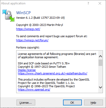

I’ve also included the dialog showing the program version number.

So WinSCP is opening a workspace with two tabs (local tab and “Cyber Hymnal” remote tab).
WinSCP should not automatically open workspace, when started normally.
So I wonder, how do you start WinSCP? Haven't you (maybe by mistake) created a desktop shortcut to open a workspace in WinSCP? And you are starting WinSCP using that shortcut, instead of the regular WinSCP application shortcut?

You are mistaking file panels:
https://winscp.net/eng/docs/ui_file_panel
with tabs:
https://winscp.net/eng/docs/ui_tabs
You want one (remote) tab with two (local and remote) panels.
You now have two tabs, the first (and the default upon start) is a local tab (two local panels) and the second is remote tab (local and remote panels). You want to close the first one and keep only the second.
