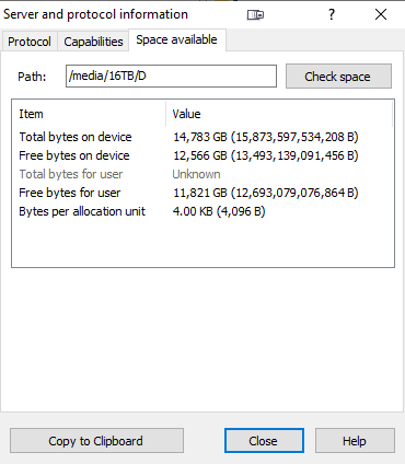

I took this screenshot (also attached), showing the "Space Available" details for the drive, which shows that only around 2TB is used and 12TB is free, but even if the drive had been full that wouldn't explain why the existing files got deleted rather than the command to move the 16GB file failing. https://ibb.co/zGyw53w
