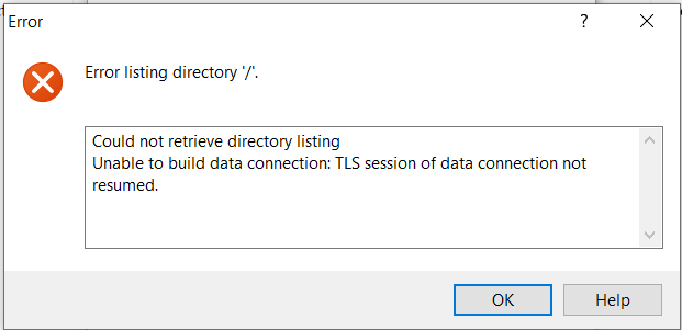

I am trying connecting to the FTP server from the external network using FTPS (explicit encryption) and getting the error
Error listing directory '/'.
The session is established, but I can't see any file in my user's directory.

I have upgraded the FileZilla Server to version 1.8, but I still getting the same error.
The "Reuse TLS session ID for data connections" session option is enabled in WinSCP client.

Hello!
After some investigations, we found that WinSCP fails to list directories while the decryption policy is enabled on our Palo Alto firewall.
When the decryption policy is disabled, connection and directory listing works fine.
There are no errors in the decryption policy log. Also, other FTP clients work with decryption policy enabled.
What data can I provide to help analyze this case?
Or WinSCP won't work with the decryption policy enabled on the firewall?
