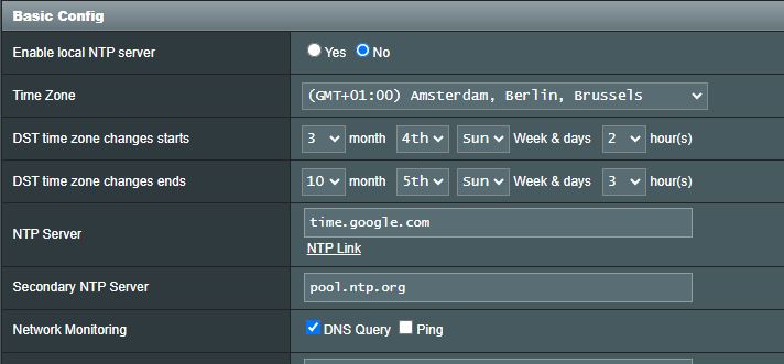

Before you ask, I also attach the screenshot of the router time and share the vsftpd.config below. I have also rebooted the router, run service restart_vsftpd and turned off/on the FTP server. The problem persist and seems caused by WinSCP.

Description: Router NTP Config
