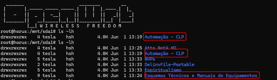

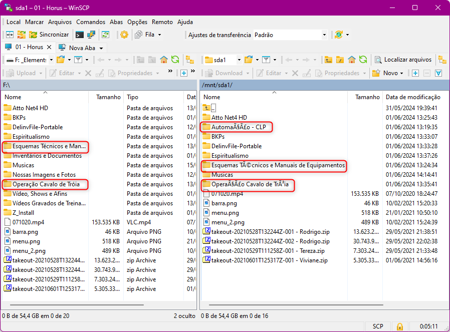

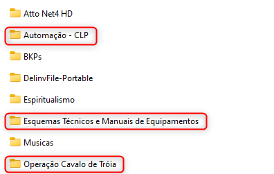

The problem is that here in Brazil, we use accentuation in some words, such as "técnico", "mãe", Música, etc... When copying these files to the HD, in Windows Explorer the files are shown correctly, if I give a ls -lh /mnt/sda1 directly on the tinypc is also shown correctly, but if I open the same location (/mnt/sda1) through WinSCP, the accented characters are truncated...

I noticed that WinSCP has code configuration, but only for UTF-8 or 1252 in the internal editor...

With SCP protocol, WinSCP requires the server to use UTF-8 encoding. It's pretty much standard for 20 years by now.
If you cannot switch to UTF-8 (why?), the try using SFTP protocol instead.
