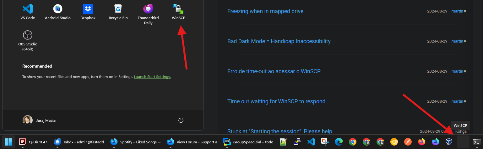

I have WinSCP installed from the Microsoft Store but this version is missing icon when I pin it to the taskbar.
The icon appears only when the app is running, once it's closed, it's gone again (see attachment).
This behavior started many months ago, I should have reported it much sooner.
I'm using latest Win 11.

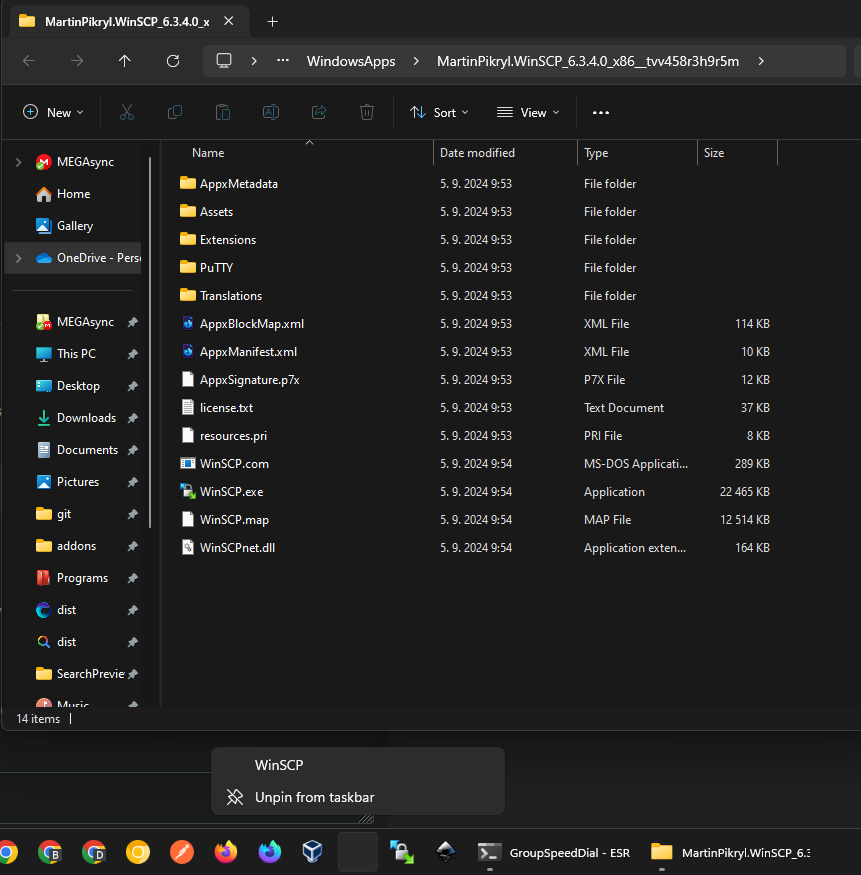

I've tried to unpin and re-pin it many times using different methods (right click when the app is running, or search it through the start menu and pin it from there).
I've just tried to reinstall it but even that didn't helped.
I've tried to pin Inkscape which I also have from the Store and that icon works fine.
I've just looked up where the app is installed and if I pin the .exe file directly, it works as expected.
