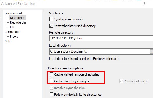

I set it to \ then after connecting it auto reverts to /\. I also tried / but again reverts to \/. I also tried removing both of the settings in the attached picture and it then saves the path without changing it but when it connects it still shows \/ on the top. WinSCP used to work for these FTP sites. Now they connect fine and I can move around but it doesn't list any files that are there like when using FileZilla.
No sorry I do not. Is this a lost cause? If so, I will stick with using FileZilla. Unless there is another alternative FTP client you could suggest? Thank you.
