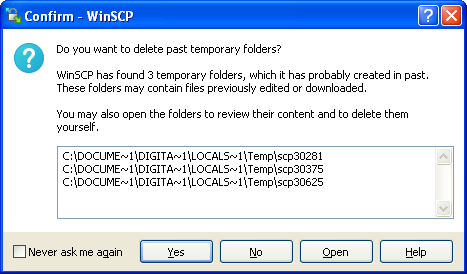

When I open WinSCP later, I get this window:
And when I click "Yes" to delete,

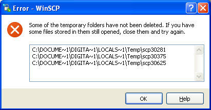

it seems that the same problem happens:
What should I do?
